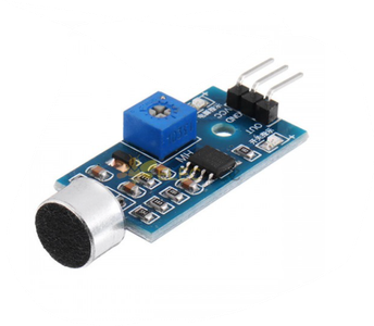

What is the Sound sensitive sensor?

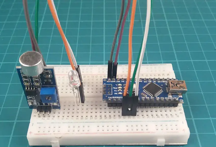

It is a sound recognition sensor. The sound sensor includes a condenser microphone. It is used to recognize sounds. If you want to change the sound recognition range, you can use the sensor’s preset controller. This sensor cannot detect sounds separately. There are other sensors on the market that are suitable for that. This sensor has three pins. It is VCC, GND, and OUT pins. VCC and GND pins are used to power up the sensor and the OUT pin is used to get output. Using this sensor we can get the digital value. We can get 0 when this sensor detects noise and 1 when it is not. We can connect this sensor to any digital pins on your Arduino board. Using this sensor we can create amazing projects. We will discuss those projects in the following articles. Today we are doing a project to blink an LED bulb using this sound sensor. The required components are given below.

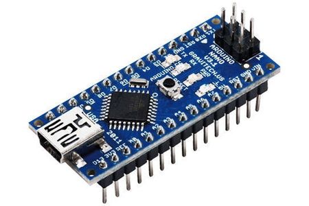

  1. Arduino Nano board —
  2. Sound sensitive sensor —

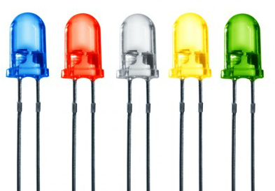

  3. LED bulb —

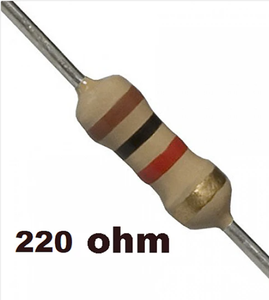

  4. 220-ohm Resistor —

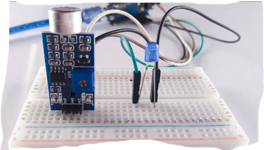

Step 1:
components

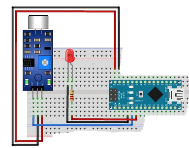

Step 2:
Please attach the components to your breadboard.
