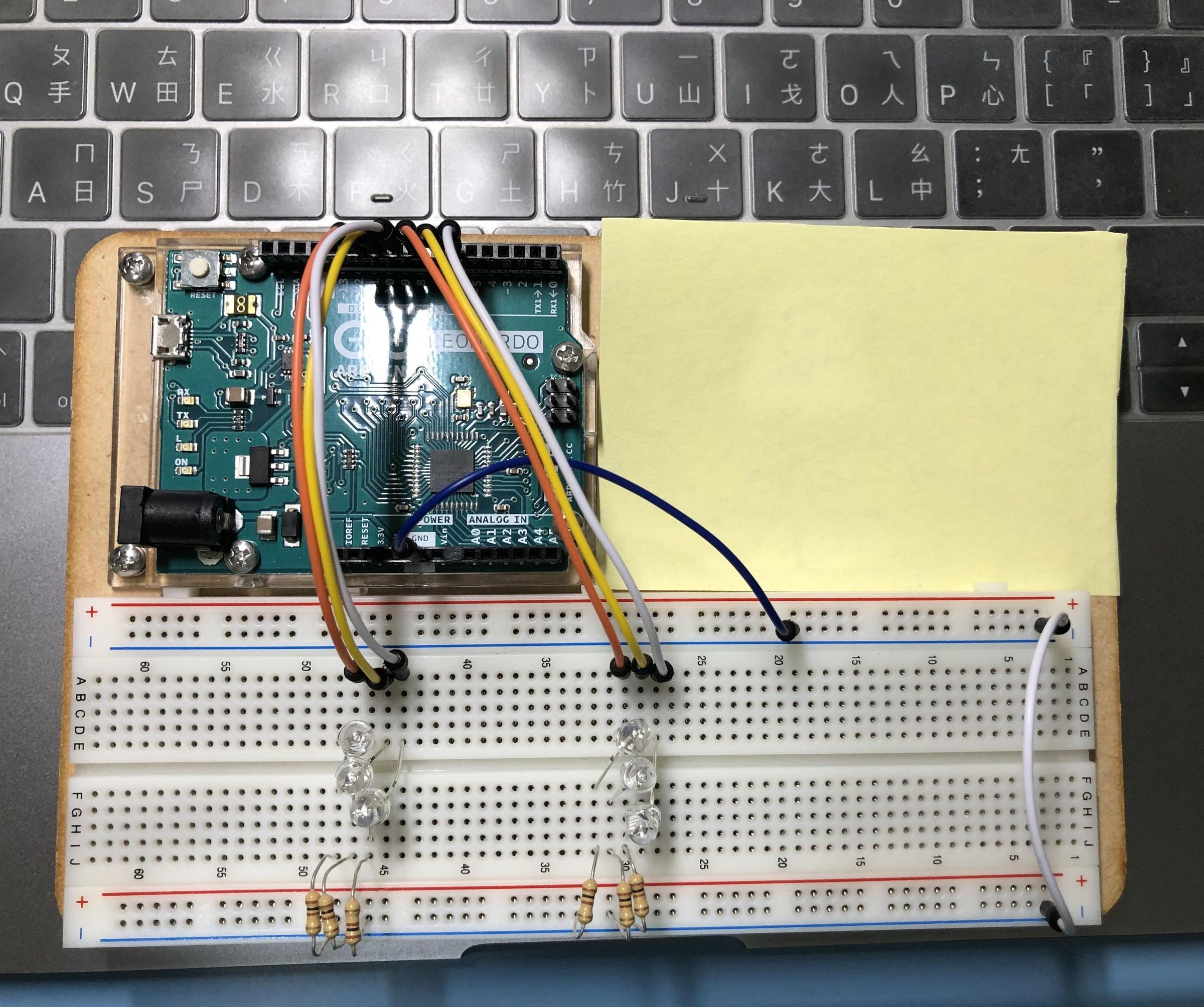

Step 1: Connecting Your Display
The OLED display should be connecting to the Arduino like the included picture.
