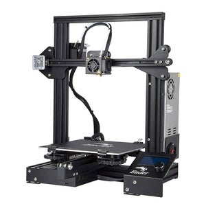

  • Turn on the machine.
  • Press the control knob and scroll to the PREPARE menu.
  • Scroll down to AUTO HOME and press the knob.
  • The hot end will move to the left front of the bed and stop.
  • Once again go to PREPARE.Scroll to DISABLE STEPPERS and press the control.
  • Next, rotate each of the four leveling wheels counter-clockwise to lower the bed below the nozzle tip
  • Slide a sheet of paper between the nozzle and the bed and slowly raise the bed until you can slide the sheet of paper between the bed and the tip with a small amount of resistance.
  • Now that the bed has been leveled you can begin the print.
  • To start the print, insert the sd card into the slot at the front of the machine.
  • Press the control knob and scroll to the PRINT FROM TF menu.
  • Scroll to the file you want to print and press the knob.
  • As the nozzle begins to heat up, remove any excess filament that may extrude from the nozzle.
  • Once the print has reached temperature it will begin extruding the first layer.
  • Watch over your printer for 15 minutes or until it has finished the first few layers as they are the most prone to fail due to the bed level being off.
  • If the first layer is not sticking correctly to the print bed, the bed may be too low and need adjustment.

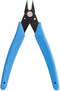

WARNING: Be careful when removing support material as there can be sharp edges on the print as well as on the wire cutters.
  • Once your print has finished, carefully remove the model from the print bed by slowly pulling back on the edges of the model close to the bed.
  • Once the model is removed from the bed, you may need to remove any support material using a pair of wire cutters.
    • To do this either cut support structure away, or use the wire cutters to pinch and pull the support structure off of the model.
