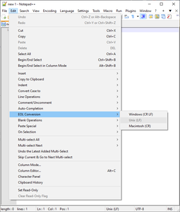

Open Notepad++ or your source code editor.
- Click "Edit," then "EOL Conversion," then "Unix (LF)"
The reason for this is that the hidden character that signifies a new line is different on Windows and Linux, so the Linux-based system wouldn't be able to read your code properly if you are using the default Windows end-of-line character.

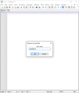

Let's go ahead and name your file as well.
- Click "File," then "Rename"
- Type "[your script name].sh" and click "OK"
Your file will now have the "SH" extension, which signifies shell scripts.

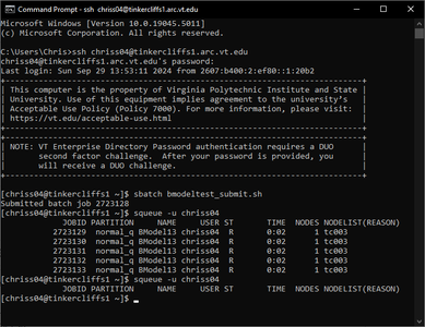

- Type "sbatch [your script name].sh"
If your script is written properly, it should respond with "Submitted batch job [number]."
- Type "squeue -u [username]"
If your job is running, it will give some information like the name of the job and how long it's been running. Keep checking on it periodically until no jobs are listed (this means they have finished). In the example image, I used a script that submits 5 jobs, so I should see 5 jobs running, and 0 once they have finished.
