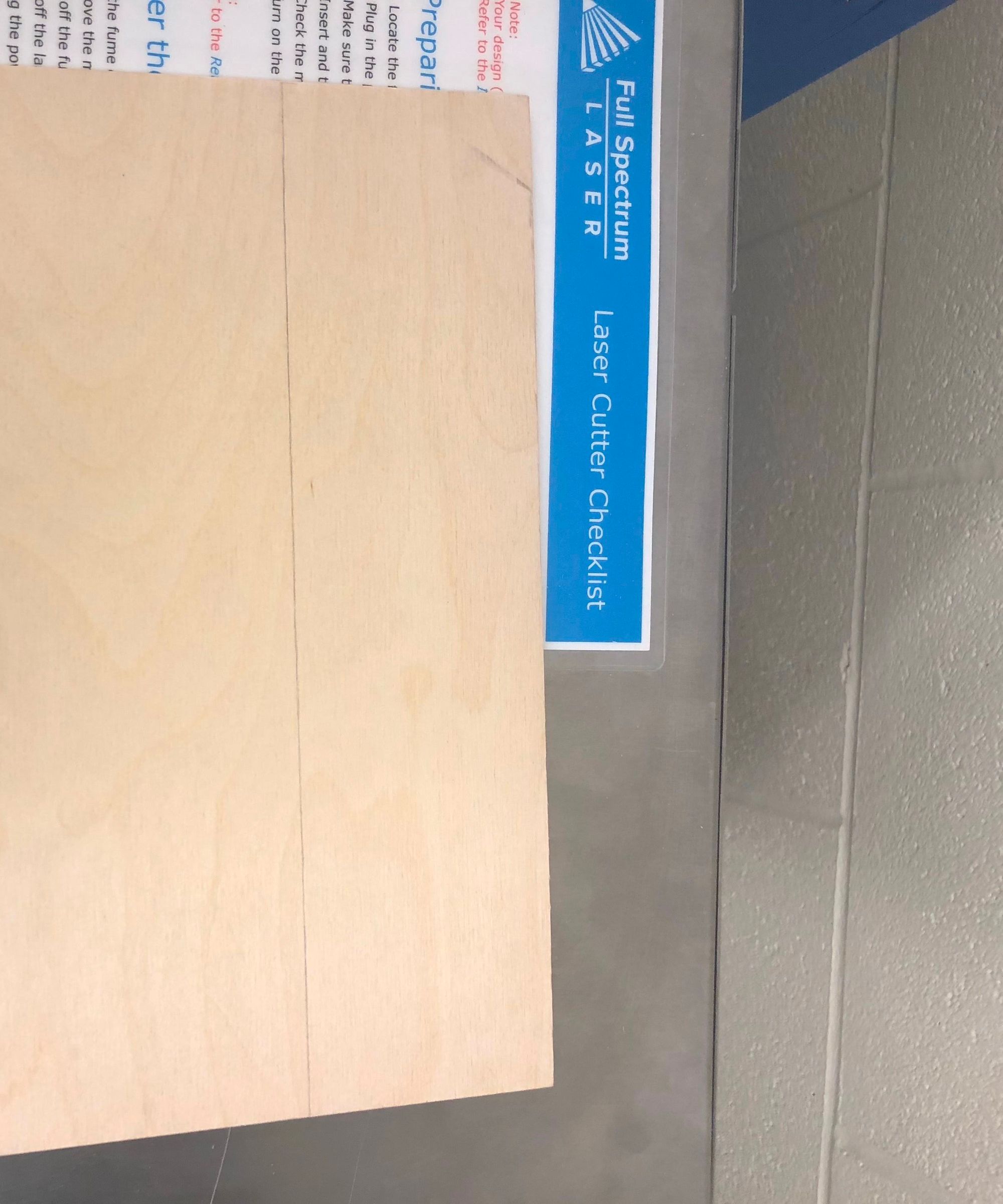

Step 7: Before You Do ANYTHING! Make Sure the Laser Is Homed First
You do this by pressing the home icon (circled in picture above) and watch the laser go to the top right corner
Step 8: Use the Jog Left/Right/Up/Down Buttons to Center the Gold Part of the Laser Over Your Material. Then Auto-focus the Z-Table
(Jog Button circled in red) (Auto Focus button circled in Black)
Step 9: Move the Red Dot of the Laser Over the Top Left Corner of Your Material. Run the Perimeter to See Where It Will Cut on the Material. Once You Have Changed the Power/speed, Press the Play Button to Start the Laser Cutter
Make sure to adjust your power to suit your material. Always ask Mrs. Freeman what is the best power to run your image at
Make sure the lid is closed and no scraps are present in the laser cutter
(Run perimeter button circled in black) (Play button circled in Red)
Step 10: A Timer Should Start in the Bottom Left Corner, Wait for the Timer to Be Done and Your Image Will Be Fully Cut
(Timer circled in red)
Some images may take longer. The more detail in the image, the longer it will take to cut
Step 11: Once Your Timer Has Expired, Home the Laser Again and Take Out Your Project From the Laser Cutter
BE SURE THAT THE LASER CUTTER HAS FULLY STOPPED BEFORE YOU OPEN THE LID
Some images may be charred, so be careful touching the cut parts of the image
