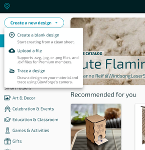

Step 2: Creating or Uploading a Design
In the upper left corner there will be a dropdown that will allow you to start a design or upload one. For this project I uploaded a design that I got off the internet. Glowforge offers some free designs on their website, there are also some one you must pay for. The file you use must be either a DXF file or a SVG file, you can also use most image files. If you are designing your own, try Inkscape or Lightburn and then save as DXF or SVG.
