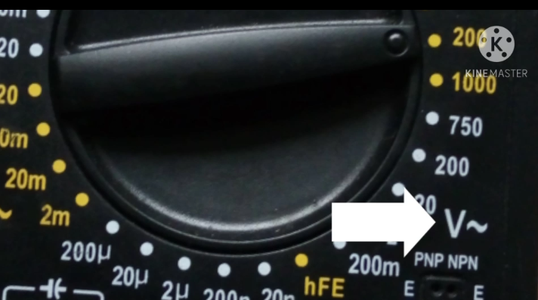

4.Voltage Ac~; The AC mode is used for measuring the alternating current from an AC wall adaptor.

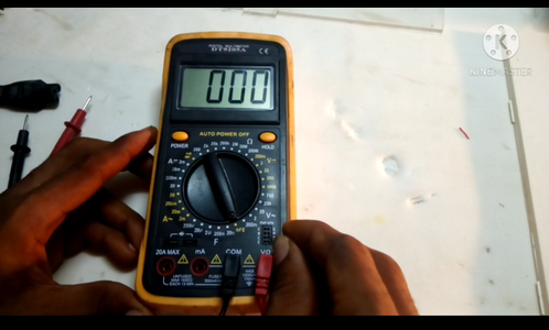

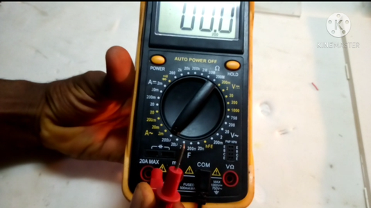

Step 1: Labeled Picture of a Multimeter
Step 2: The Meter Connectors
The are two wires that comes with a multimeter, this wires are called probes, the are black and red in color, the red is the positive probe and the black is the negative probe. In the multimeter there are four ports but most multimeters comes with three port, the positive probe should be connected to the VΩ and the negative Probe will be connected to COM.

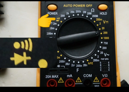

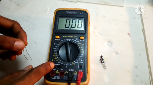

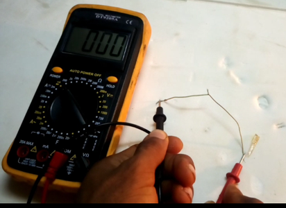

Step 3: Continuity Mode
First let us start with the Continuity mode, to show how it works I have a wire that has not been bridged, by testing the wire the is no beep sound, but bridging the wires there is a beep sound, with this mode we can test fuse's to know if the are burnt.

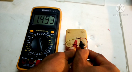

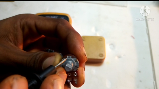

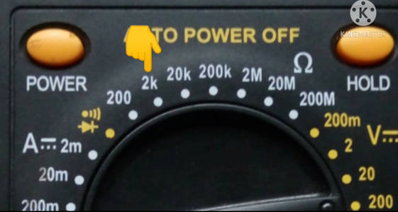

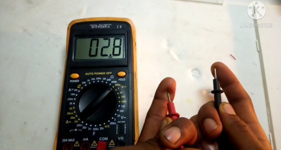

Step 4: Resistance Mode
To show how the resistance mode works I'm going to measure a resistor. The 200 digit in this multimeter stand's for 200 ohms, so keep in mind that if you measure a resistor or any other conductor above 200 ohm the will be no reading in the meter. So adjusting my meters knob to 2k, 2k signifies two killo ohms which means two thousand ohms, by connecting the probes to a 1k virable resistor, the meter indicates 1.493 which is probably just 1killo ohm, so that goes for the 20k and 200k.
Adjusting the meter's knob to the 2M function, 2M means two million ohms, testing a 1M ohm resistor I have a reading of 1.013 which is probably just 1Million ohm's so that goes for the 20M and the 200M.

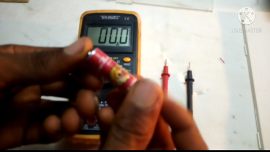

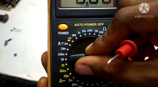

Step 5: Voltage DC Mode
Adjusting the meter knob to the 200m in the DC mode, 200m signifies 200milli volts, by touching the probes terminal's i will measure the EMF from my body and it works just fine, this can be applied to thermocouples because the generate milli volts the same thing goes for 2v. Adjusting the meter knob to the 20v function I will measure the voltage of a dry cell battery, we have a reading of 1.28volts DC, the same thing goes for the 200v and 1000v DC mode which can be used to measure higer dc voltage.

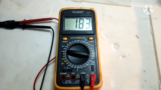

Step 6: Voltage AC Mode
Warning❗high voltage AC is extremely dangerous, be sure to understand the Ac safety protocol's before working with ac devices. Adjusting the meter's knob to 750volts in the Ac mode I'm going to measure the output voltage from my ac wall adaptor, so here we have a voltage output of 183volts AC, the same thing applies for 200v,20v,2v,200milli volts ac.Note that when using this functions you must only measure voltage's below the rated voltage.

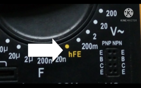

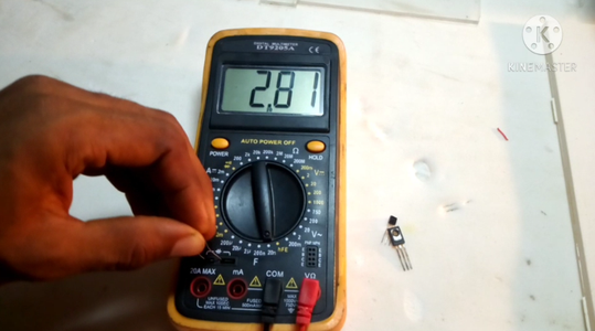

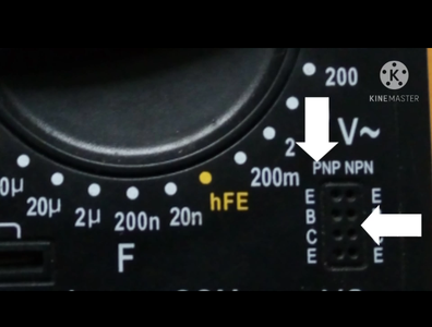

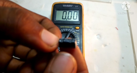

Step 7: HFE (Hybrid Parameter Forward Current Gain Common Emitter)
We can tell the differences between an PNP and NPN transistor with the HFE mode this mode comes with a socket and some letters, B,C,E. ''B'' stands for base, ''C'' stands for collector and ''E'' stand's for emitter. To show how it works, I will insert a bc547 transistor in the NPN socket, as you can see we have some readings which shows that it is an NPN transistor. Note that if we connect the emitter, base, collector pins the wrong way, then the meter will indicate an error.

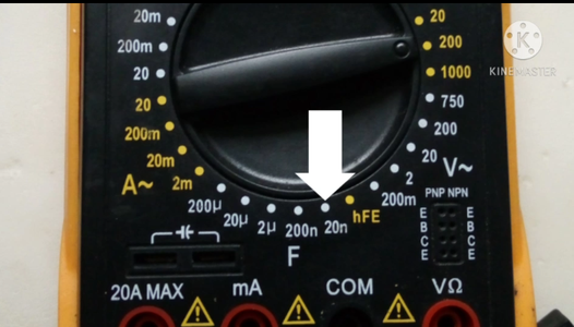

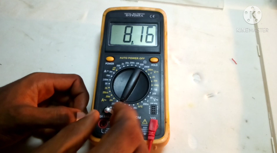

Step 8: Capacitance Mode
The capacitance mode is used to measure the capacitance of a capacitor it has a socket where the capacitor's are being inserted with a capacitor symbol, to show how it works I'll start with the 20n which means 20nano farad. Measuring a capacitor with low capacity, we have a reading of 0.11nano farad, same thing goes for the 200n. Moving on to the 20u function 20u means 20micro most capacitor's like the electrolytic capacitor's have polarity, connecting an electrolytic capacitor in a correct polarity, i have a reading of 8.16micro farad, the same thing goes for the 2u and 200u.

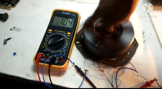

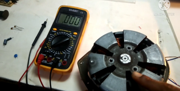

Step 9: Current AC(~)
In this mode i will change the connection of the negative probe, and insert it in the 20A MAX port, adjusting the meter's knob to 2m in the A~ current mode 2m means 2milli amp, I am going to measure the output current of an AC alternator, as you can see i have a reading of 104 milli amp. Note that amp meters should always be connected in series with source and a load, so the same thing goes for the 20m, 200m, and the 20 mega amp.

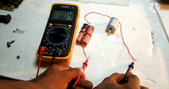

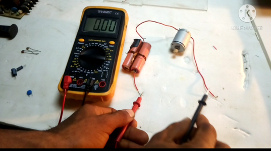

Step 10: Current DC (⎓)
Starting with 20, the digit ''20'' signifies 20maga amp, to show how it works, i will measure the current draw of a DC motor. By connecting a battery in series with the motor and the meter, the meter indicates a current draw of 0.04amp the same thing goes for the 200m, 20m and the 2m.
