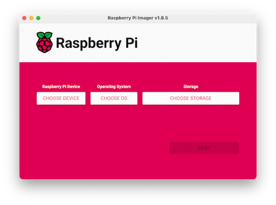

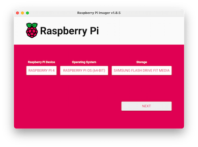

  2. Download the Raspberry Pi Imager and launch it.
  3. Click CHOOSE DEVICE. Select your model of Pi, which is Raspberry Pi 4.
  4. Click CHOOSE OS. Select Raspberry Pi OS (64-bit) from the menu.
  5. Click CHOOSE STORAGE. From the list of devices, select the USB flash drive you intend to use in your Raspberry Pi.

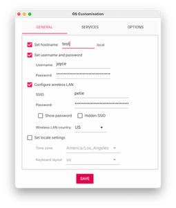

  6. Configure your Raspberry Pi for remote access. Click Next. When prompted to apply OS customization settings, select EDIT SETTINGS.
  7. Check Set hostname and enter the name you would like to access the Pi by in that field, for example, test.
  8. Select the checkbox for Set username and password and set a username (for example, your first name) that you will use to log into the Pi. If you skip this step, the default username will be pi (not recommended for security reasons). And specify a password.
  9. Connect your Pi to Wi-Fi so that you can run viam-server wirelessly. Check Configure wireless LAN and enter your wireless network credentials. SSID (short for Service Set Identifier) is your Wi-Fi network name, and password is the network password. Change the section Wireless LAN country to where your router is currently being operated.
  10. Select the SERVICES tab, check Enable SSH, and select Use password authentication. raspberry pi enable SSH
Be sure that you remember the hostname and username you set, as you will need this when you SSH into your Pi.
  1. Save your updates, and confirm YES to apply OS customization settings. Confirm YES to erase data on the USB flash drive. You may also be prompted by your operating system to enter an administrator password. After granting permissions to the Imager, it will begin writing and then verifying the Linux installation to the USB flash drive.

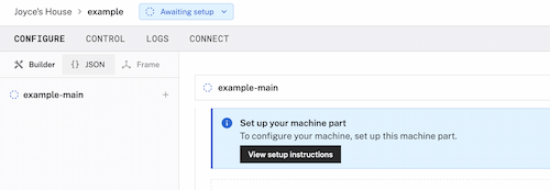

  1. In the Viam app under the LOCATIONS tab, create a machine by typing in a name and clicking Add machine.
  2. Click View setup instructions. setup instructions

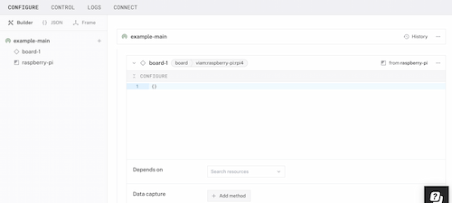

To access the GPIO pins, let's add our Raspberry Pi board to our machine in the Viam app.

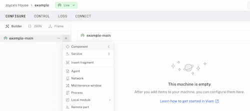

  1. In the Viam app, find the CONFIGURE tab.
  2. Click the + icon in the left-hand menu and select Component.
  3. Select board, and find the raspberry-pi:rpi4 module. This adds the module for working with the Raspberry Pi 4's GPIO pins. Leave the default name board-1 for now.
  4. Notice adding this module adds the board hardware component called board-1. The collapsible card on the right corresponds to the part listed in the left sidebar.
  5. Click Save in the top right to save and apply your configuration changes.
  6. Expand the TEST section of the panel to experiment with writing to physical pin 35. For example, try setting a High signal, along with 70% duty cycle and 1200 Hz frequency. test GPIO pins on board

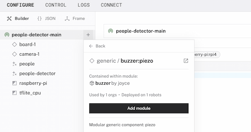

  1. In the Viam app under the CONFIGURE tab, click the + icon in the left-hand menu and select Component.
  2. Select generic, and find the buzzer:piezo module. This adds the module for controlling your buzzer. Name the component piezo. select generic piezo component

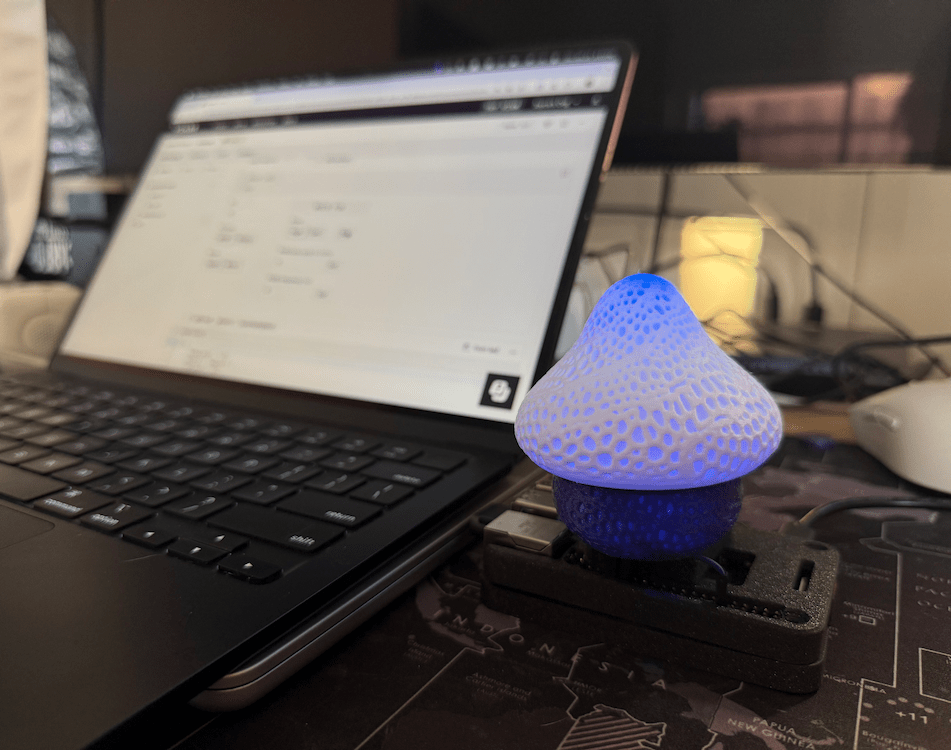

You can 3-D print a case for the Raspberry Pi that allows access to your GPIO pins for expanding your project (like this one here). You can also design and 3-D print a custom mount to hold your buzzer in place, or 3-D print a megaphone (like this one here) to amplify the buzzer volume.
