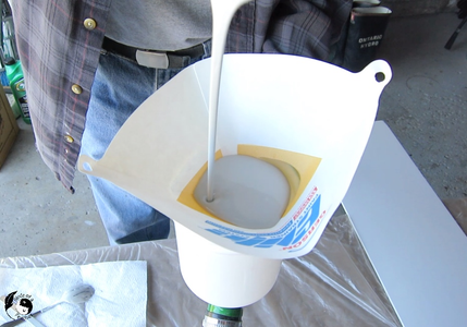

As someone who LOVES to paint, I had to try chalk paint in an HVLP paint sprayer! Check out our post on How to Paint Using a Spray Gun to get Hub’s professional paint sprayer tips and tricks! If he can teach me how to spray paint, you can do it too!
Since chalk paint is too thick to spray through a paint gun as-is, it needs to be thinned out first. Thin Dixie Belle chalk paint by using Floetrol, water or a combination of both. Generally the ratio is 4 parts paint to 1 part thinner. However, you may notice that some of your chalk paints are thicker than others, so this isn’t an exact science.
Our advice is to mix in enough thinner to allow it to run freely through a paint strainer. If it strains easily, you won’t have a problem with flow through the paint gun. It’s also a good idea to use a larger tip. We’re using a paint sprayer with a 2.3 mm tip.
After cutting an extra scrap of smooth wood, we’re spraying it with Driftwood so I can try stencilling the mandala again. Dixie Belle paint sprays on beautifully! Again, you’ll need two light coats for the best coverage with a light colour like Driftwood.
