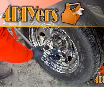

Step 2: Foot Pound Torque Wrench
Now to set the torque wrench. They should have some form of a lock which needs to be disengages, then rotate. This vehicle which is a 1998 Ford Ranger, the wheel torque spec values is 100 foot pounds. Rotate the handle and then line it up on the scale correctly. We will have larger increments on the barrel scale, so there will be 10 foot pounds in between each number. Then to setup the single value increments, the scale around the handle is needed for that. Align the number line on the handle with the center line on the barrel, so considering this is 100 foot pounds, the handle number line will be zero. If it were 105 foot pounds, then align it to 5. Next ensure the lock has been applied, otherwise you do risk adjusting the setting when torquing a fastener. Use one hand to hold the pivot in place, then the other on the handle. Rotate the torque wrench until the it clicks. You should be able to hear, feel and see the click. As soon as that click activates, immediately stop turning. One click is all that’s needed, otherwise you do risk over tightening the fastener. When done with the torque wrench, position the scale back in it’s lowest position. Otherwise this will jeopardize the accuracy of the torque values.
