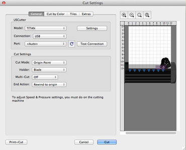

Step 6:
Click “Cut With Cutter” and then click cut
