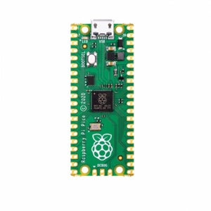

Step 2: Raspberry Pi Pico
Raspberry Pi Pico is a little, fast, and versatile board built using RP2040, a brand-new microcontroller chip devised by Raspberry Pi in the UK.
A Raspberry Pi Pico is a low-cost, high-performance microcontroller board with flexible digital interfaces.. Microcontrollers are tiny computers, but they tend to lack large-volume storage

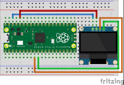

Step 4: Circuit Diagram - SSD1306 OLED Display With Raspberry Pi Pico
You can guide to the circuit connection of the Raspberry Pi Pico and OLED display module as shown below.
- The SDA pin of the OLED Display Module is connected to the GPIO16(Pin21)
- The SCL pin is connected to the GPIO17(Pin22).
- The Vcc pin is connected to the 3.3v Pin of the Pico Board which is Pin36.
- The Ground pin of the Display module is connected to the Ground pin of the Pico board which is Pin38

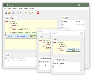

Step 5: Software and Libraries
To use the Pico board with the library, you'll have to use the thonny IDE with Raspberry Pi Pico board support. If you haven't already done that yet, you can easily install Raspberry pi pico Board support to your Thonny IDE by following this tutorial
