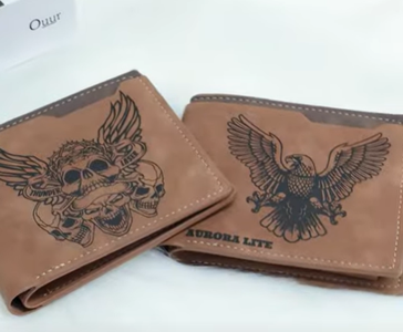

laser marking leather wallet
Step 6: Complete the Laser Marking
Once laser marking is complete, carefully open the door and get your personalized leather wallet. Laser marking does not produce toxic substances, and you can use it after a simple cleaning!
Come and Try!
Perfect for professionals, thoughtful gift-givers, everyday users, or lifestyle brands, laser marking leather wallets is simple to personalize, quick to produce, and built to last, making them a top choice for small creative shops and premium custom retailers alike. With endless marking options from elegant monograms to meaningful symbols, these wallets add a personal touch to daily essentials and arrive ready to impress in any setting.
laser marking leather wallet done
