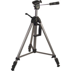

If you're going to videotape anything that is more-or-less static (like a stage from the audience), you MUST have a tripod. It need not be a fancy tripod with fluid-stabilized video panning capability, because for the most part the camera shouldn't move very much (more on this later.)
Lack of a tripod will make your video wobble and give you cramps in your arm before 20 minutes has gone by.

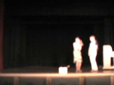

Today's cameras all have automatic exposure. This works by adjusting the camera's exposure to match the amount of light the camera sees, and it works pretty well in many cases. HOWEVER, the dark background and bright frontal stage lighting typical of amateur (or professional, for that matter) performances is NOT a situation that works well with most automatic exposure systems. The dark background (and sometimes the dark surroundings of the camera) fool the camera into overexposing the parts of the picture that you really want to see, like peoples' faces.
So before arriving, review your camera manual to figure out how the manual exposure settings work. Some cameras may have special automatic exposure settings specifically designed for "spotlight" type situations, and those are probably better than nothing. It can be hard to predict how dim or bright stage lighting is going to be, but you can get a ROUGH guess by setting the exposure when the room lighting is on, and then you should only have to adjust somewhat for stage lighting. Once you have an exposure that's approximately correct, you can just LEAVE IT THAT WAY. Dimming lighting will look dimmer, brighter lighting will look brighter, and unless things go too far in either direction, that's really the way you want the recording to look.

Todays cameras also have automatic focus. Great stuff, but autofocus also tends to be confused by stage lighting. Your camera will sit there trying to figure out what to focus on before the lights come up, and it will get it WRONG, so that when the lights DO come up you have a fuzzy image till it makes a better guess.
Review the other section of your camera instructions to figure out how the manual focusing works. For a start, zoom in and focus on the curtain or part of the scenery using room lighting before action starts. Video cameras SHOULD maintain focus when changing zoom settings. If you're relatively far back from the stage and the stage is relatively shallow, you can probably just leave it at that setting. Otherwise, know which direction of which knob moves closer or further away, and get a feel for how fast the focal distance changes.

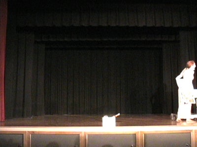

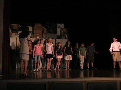

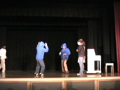

Given the previous suggestions and comments, one strategy that works surprisingly well is to just set up the camera so that its view encompasses the entire stage, turn it on, and then DON'T TOUCH IT till the curtain goes down. This has other advantages as well: you can sit back and actually watch the show instead of trying to fiddle with the camera. Or, you can take still shots with a still camera. Don't whisper to your neighbors, though, cause the camera's microphone is a lot closer to you than it is to the stage.
The videoclips are of a scene where there is "surprise" action at the edges of the normal stage. In the first clip, I had zoomed in some on the two ladies, and resorted to distracting panning and zooming to get the action back into the frame. In the second clip, the camera was essentially unattended, and I think captures the scene better. (people who are paying attention will notice that the first clip is from the second night of taping, and has correct exposure and focus, while the better framed clip has the bad exposure and focus. Sigh.)

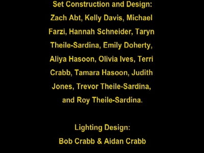

The most important thing added during video editing is probably the credits. I have a pretty simple rule that I find useful: if the people putting on the show mentioned someone in the printed program, then that person also ought to appear in the credits in the video. If you can, get photos or short clips of the stage crew, the lighting and sound people, and so on. They're working hard too, and they hardly ever get to be on youtube!
