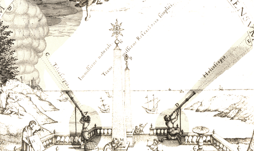

Step 2: Telescopic Viewing
The man on the left (at A) appears to be doing something massively unwise: trusting his precious vision to a bit of cloud that is thin enough to let the sunlight through (at B), but still thick enough to protect his vision. Don't do this. If you really want to look through a telescope (or binoculars) use a solar filter designed for that purpose (that you're sure is fully intact).
The man on the right (at D) at first glance appears to be in the act of blinding himself (from the sun at E). But since this is described as a "Helioscopio," I suspect that he's actually looking at a projection screen, rather than letting the image from the telescope be formed directly on his retina. A larger projection screen works even more nicely, and allows several people to view the sun at once. You can search for "sun gun telescope" to get the idea. These are great, but require a telescope, a sturdy mount, careful alignment, and time to build it. Not much of an option for those not already into astronomy (or those procrastinators who waited until now).

The man at the lower left (T) is using two different methods at two different times.
Single Lens Viewing
When the sun is at Q, light passes through a simple converging lens (R), to reach a screen (S). In principle, this is easy to do: every magnifying glass is a converging lens. But the image only comes into focus at one particular point - the focal point of the lens. And unfortunately, the image of the sun will be very small unless the lens has an extremely long focal length (as suggested by the figure). That's why you can burn things with a magnifying glass: the image of the sun is tiny, concentrating a lot of energy in a small space. Trying to stare at that is almost as bad as staring at the sun, and won't let you see any details anyway.

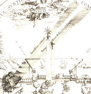

My favorite experiences sharing solar views have used mirrors.
In this image, a man has a small mirror (K) mounted to a board. He reflects that light, directing it to the shady portion of a (presumably white) pillar forming an image at L. Man M then gets a nice close-up view view of the sun, which he can sketch and measure (N).
Perhaps this man is having fun because this is so easy.
