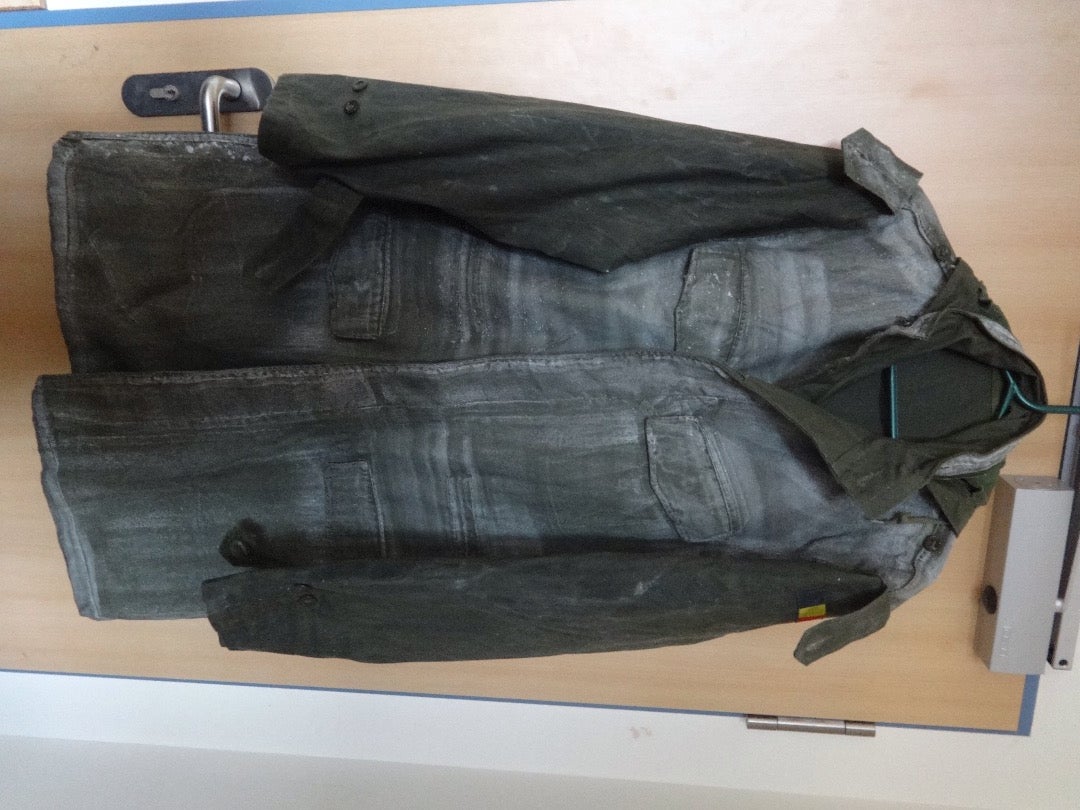

Rub the wax block over the clothing
At this point, I noticed that the metal pattern from the ironing board was coming through to form a pattern on the sleeve of the jacket. A simple fix, I just added a folded towel between the ironing board and jacket, problem solved.
When applying the wax, compartmentalise the clothing. I began with the sleeves, front half and rear half.
Cover the area fully with wax, the more the better.

Step 7: Apply Heat Using Hairdryer
What took 10 minutes using the iron, took seconds to achieve using the hairdryer, the upper half of the sleeve took 30 seconds to complete.
Repeat process to achieve a double coating of wax.
Do the same on the other half of the sleeve, applying two coats of wax and paying particular attention to the areas of overlap.
Repeat the same set of steps on the other sleeve.
Once I completed both sleeves, I had used most of one block of wax. (I've placed a whole block next to the used block for comparison)
Step 8: Apply Wax to the Rest of the Jacket
I applied the first coat of wax to the rest of the jacket, the pictures show the difference in colour once the wax has been applied.
By this stage I've applied two coats of wax to the sleeves, one coat of wax to the main body of the jacket and have used two blocks of wax. (I've placed a whole block next to the used blocks for comparison)

Once I was graciously allowed to resume my usage of the hairdryer, I was able to melt the wax into the jacket quite quickly.
That left the application of the second coat of wax and heating it so that it melted into the fabric.
In comparison to the events of the day, it was simple and relatively unhindered.
That only left the hood, which took just over 15 minutes to complete both coats of wax.
By the time I had completed all the waxing and heating, I had used three blocks of wax. (I've placed a whole block next to the used blocks for comparison)

Step 12: The Finished Article
The jacket, including hood is completed.
