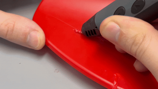

Step 4: Repairing Cracks
  • Start extruding plastic at the end of the line that needs to be soldered
  • Push the tip of the pen into the part such that the plastic starts to melt from the tip and new material is placed in the newly formed gap
  • Slowly move towards the other side of the line, going in the direction of your wrist
  • Once the end of the line is reached, move slowly in the opposite direction placing material in possible empty spots
  • When the starting point is again reached stop extruding material, but do not move the pen immediately from the part and let the remaining hot plastic ooze out and cool down for a few seconds before pulling away from the part
  • Wait for the repaired section to cool down completely -- this should not take more than a couple of minutes for small pieces.
