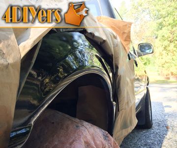

Moving onto a two-stage paint, this involved a clear coat. The clear coat as pealing on these fender flares so they were removed from the truck, sanded down, has a primer applied, then a base coat which is the color, and finally a clear coat. Again you will need to ensure you do have enough paint to work with. If you sand through the clear coat, the final finish is damaged and you may need to apply more clear coat or have to redo the surface altogether.
Same steps as before, make sure the paint is cured enough to work with. These were left for a few weeks by the time I got around to polishing them.
Step 7:
Ensure the surface is clean, pre-wet the area and that sandpaper will also need to be pre-soaked. Start with 1000 grit to remove the majority of the orange peel. Considering these a curved sure, either use a very flexible backing pad, a soft foam block or if you’re comfortable enough, use the palm of your hand. Only apply light pressure, allow the sandpaper to glide over the surface.
Step 8:
Once most of the surface imperfections have been removed, move onto 1500 grit sandpaper. Rinse the area as needed, in this case considering I’m only sanding clear coat, the sanding residue will be a milky color. If a color is shown, then you’ve gone too far and have hit the base coat color.
Step 9:
2000 grit is intended to remove the 1500 grit marks and it’s fine enough to move onto the polishing process. Rinse the area and sandpaper as needed, keep the area well lubricated and work evenly across the surface.
Drying the surface will show the finish before moving onto polishing. Now I’ve only wet sanded the outside visual area, the area inside the fender well has been left as is. That way you’ll see a comparison between the original surface and a polished finish.
Using the same polish as before, apply it to a cloth or pad and then work it into the surface. Medium pressure is needed to help cut back those sanding marks and bring up a final shine. Again only clear coat is being polished so you won’t see color on the cloth. If you see paint color on the cloth, you’ve polished through to the base coat. With single-stage paints, it’s normal to see paint color on your polishing cloth.
With the fender, as an example using a machine polisher. There are various abrasive ratings of pads available, I’m using a fine polishing pad with the same polishing compound as previously. It’s much easier using a polisher, however, it’s much easier to damage the paint surface. Just allow the weight of the polisher to lay on the surface, do not apply excessive pressure or hold in the polisher in one area. Work across the surface evenly and as you can see the shine is coming back.
Just like before you’ll need to let the paint cure before a wax or sealer is applied. When the paint is curing, it gives off gases and if it doesn’t breathe properly, this may have negative effects on the curing process.
Any access polish is just cleaned away using a soft microfiber cloth.
