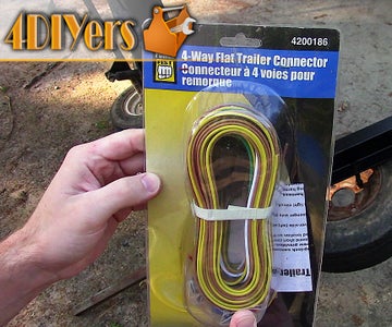

Here is the brand new generic wiring harness. This is just a standard 4 way connector with a ground, parking, and signal or brake lights. I believe there is about 25ft of wiring which should be plenty for a trailer of this size. They also provide the vehicle side connector too which I don’t need as the tow vehicle already has that installed. As you can see on the back of the package, they typically provide a guide so if you need extra help, this is a great reference guide.
Next I have 1/4” diameter, 25ft in length poly split loom casing to protect the wiring. This is a must considering the wiring will be on the underside of the trailer and is exposed to moisture, gravel, maybe salt from winter, road grim, and anything else that could damage the insulation on the wiring.
