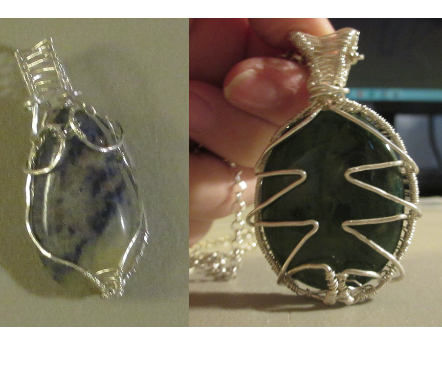

Wrap the bail, making sure to include the fourth piece of wire. Wrap around the bottom two wires three times, around the middle two wires three times, around the top two wires three times, around the middle two wires three times, and around the bottom two wires three times. Then repeat. Cut the tail long.
Step 10: Tails
Put the stone in and wrap the little tails of wire (including the beginning tail from earlier) around the fourth piece of wire. This part is inspired by Oxanacrafts.
Step 11: Bail (again)
Bend the bail around a round object or your finger.
Step 12: Loop De Loops (again)
Make loops at the end of the bail, wrapping the loops around the fourth piece of wire. Wrap the tail of the bail around the fourth piece of wire as well.
Step 13: Securing the Stone
If the stone is still not secure, make a little divot in the pendant and tie an extra piece of wire around the fourth wire and the pendant. You're done!
