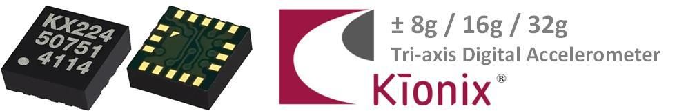

The KX224 1053 is a microelectromechanical ±8g, ±16g or ±32g Tri-axis Digital Accelerometer an integrated 2048-byte buffer chip, with orientation directional tap, double-tap, movement detection, and free-fall sensing. The KX224 algorithm is developed and fabricated by KIONIX plasma micromachining process technology. The KX224-1053 sensing is based on the principle of a differential capacitance from the acceleration-induced motion of the sense element which is additionally utilized by mode cancellation to decrees errors from process variation, temperature, and environmental stress. however, an integrated separate ASIC (Application-specific integrated circuit) sensing package inside of the chip provides a signal conditioning and intelligent user-programmable application that can sense any variations.
ASIC Integration This integrated ASIC (Application-specific integrated circuit) device is responsible for sensing all the signal conditioning and communication with the sensor. The complete measurement chain is composed of a low-noise capacitance to the voltage amplifier which converts the differential capacitance of the MEMS (Micro-Electro-Mechanical Systems) sensor into an analog voltage that it will send through the analog-to-digital converter. The acceleration will be accessed through SPI or I2C communication provided by the ASIC (Application-specific integrated circuit). Also, the ASIC contains all the logic that enables you to choose the data rates, g-ranges, filter settings, interrupt logic, and the two programmable state machines which allow you to create a unique embedded function based on variations, changes in accelerations. KX224-1053 Working Voltage
This chip works on 1.7v to 3.6v DC. However, this sensor requires a regulator for constant internal operating voltage over the range of input supply voltage. This will occur in a stable operating characteristic over the range of the input supply voltages. This device communicates with i2c or SPI protocol used for communication through the chip orientations such as directional tap, double-tap, and free-fall detection and any activity monitoring sensing. The KX224-1053 can be used in automotive applications, home appliances, industrial equipment, automation, robotics, drones, or any devices that need movement sensing. For more technical details please refer to the datasheet below. Particularly for the protocol communication address.The Diagram below is using ATMEGA4809 development board. however, you can also implement the diagram using SONY ESPRESENSE, ESP82, ESP32, NodeMCU, ESPDuino, Teensy 3, MSP430 Launchpad, Flora, Metro, Trinket, Pro Trinket, please note that each development board has its different pin-out mapping.
