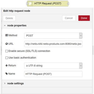

HTTP Request(POST)
This node sends a netio.json command file as a HTTP Request (POST) in order to control the NETIO 4All device.

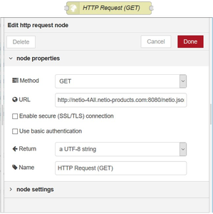

HTTP Request(GET)
This node sends a HTTP Request (GET) and returns the status response.
Thepre-filled address points to the NETIO 4All online demo, where you can test the connection without having a NETIO device at your desk.
http://netio-4all.netio-products.com
It is possible to set your own IP address in these nodes; however, the IP needs to be changed in both the HTTP Request nodes, POST as well as GET.

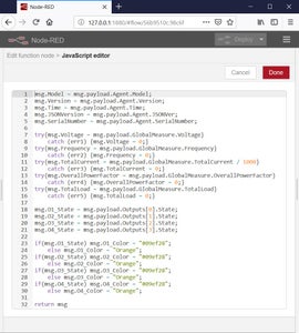

Step 8: Function Node
A function node is a special node that enables writing a custom JavaScript function.
In this instructable, the function picks values from the parsed JSON file (now a JSON object) and assigns them to the properties of the msg object.
The code is divided into four sections:
  1. Assigning values from the JSON object to the individual properties of the msg object
  2. Error handling in case the networked power socket does not support global measurements
    • If the networked power socket does not support the measurement of global values, Node-RED would display errors because this function would not find the respective property, e.g. msg.payload.GlobalMeasure.Voltage, since it would not be present in the JSON object. In this case, the property of the msg object, e.g. msg.Voltage, is set to 0 and the error is caught a handled.
  3. Assigning output state values
  4. Setting the colors of the displayed output state values according to the output states

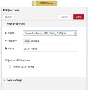

Step 9: JSON Node and Inject Node
JSON node
JSON node parses the JSON file and transforms it into a JSON object.
As a response from the server to the GET request, the HTTP Request node returns a JSON file containing the current status of the NETIO 4x device, but is is simply a text file, so in order to work with the data, the JSON file needs to be parsed into a JSON object.
