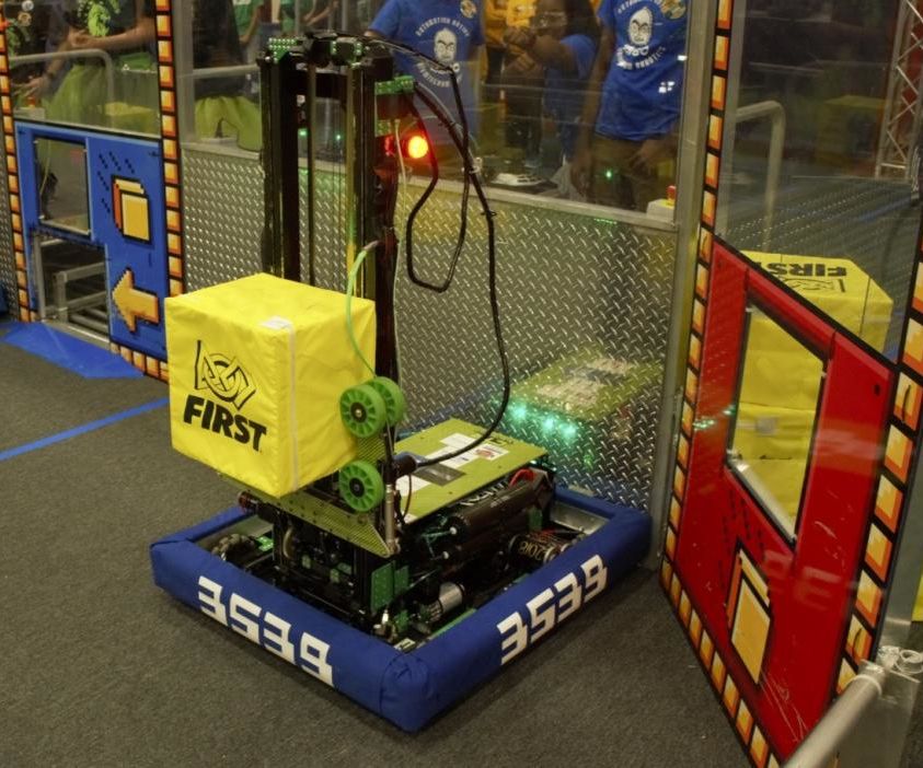

Introduction: How to Write a Simple Drivetrain for FRC (Java)
This is a tutorial on how to make a simple drivetrain for a FRC robot. This tutorial assumes that you know that basics of java, eclipse and already have wpilib installed, as well as CTRE libraries.
