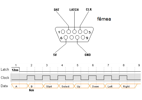

Step 2: How the Controller Works
Well, let's begin by the start. Let's understand how a NES Controller function, it's important to say that this step independs if the controller it's the original one or the clone one, the internal functionality is the same.
Internaly the controller what we call in digital eletronic parallel-to-serial register, a integrated circuit that store the state of each button (pressed or not) when a "lacth" pulse is given, then the register send each state alwaysa clock pulse is given.
So it's cleare that the controller have 5 wire, they are: VCC, GND, LATCH, DATA, CLOCK.
So the algorithym to read the buttons states is very simple:
1 - Give a latch pulse;
2a - Verify the DATA wire;
2b - Give a clock pulse;
3 - repeat 2a and 2b until all the buttons states were read;
Here are the code sample witch contain the read controller function:

The code are in C and was written on PICC CCS compiler but is so simple to understand.
The intervals length can be seen more easily in the picture below.
It's more easy find the pin-out diagram of the original NES controller connector in the internet, so in the picture is also show the pin-out diagram of NES clone controller connector.

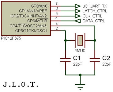

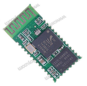

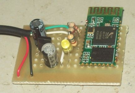

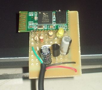

Step 3: How the Bluetooth Module Works
This step it's very simple, the bluetooth module came with a default configuration, the device name is "linvor" and the paring code is "1234", both can be set and reset by AT commands.

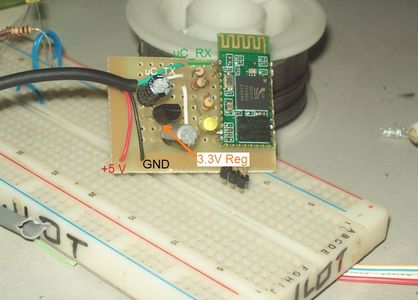

So just buy one of it and join the party. But here a important information, this module works with 3.3 V and we need 5 V to make the controller works (actually a don't test power on the controller with 3.3V :-) ).
To power on the module you just need to regulate your 5 V source to 3.3 V (with a lm317, lm7833 or other regulator), but the TX pin that came from the PIC microcontroller have 5 V as high logic level, so we need a voltage divider to decrease the 5 V to 3.3 V, this will drive correctly the RX pin on BT module.
The correct connection:
TX_uC_PIN (5 V) ----> voltage divider ----> RX_BT_PIN (3.3 V )
The images below show the voltage divider and the uC pin out.

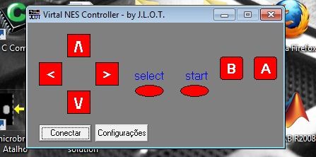

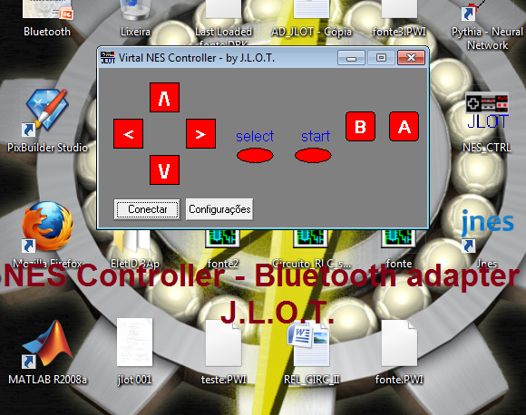

Step 4: How the PC Software Works
The software just simulate a keyboard key press event, the firmware inside PIC read from the controller wicth buttons are pressed or not in this sequence: A - B - Select - Start - Up - Down - Left - Right. If a button is pressed the respective bit becames '0' otherwise the bit becames '1', so if the gamer pressed the Up, the right and the A button, the bits carrier is: 0 1 1 1 0 1 1 0, or in hexadecimal 0x76, or in decimal 118.
Note that if I was send the buttons information in binary it would take 8 bytes length ("01110110"), if was send in decimal would take 3 bytes ("118") and if it was send in hexadecimal would take two bytes ("76"). But exist a better way to send this information, note that we have 8 bits, so we can send it like a character, if we take a look in the ASCII table 0x76 correspond to 'L' character, so we just need to send 'L' to transfer all the information.
So is this what the firmware does, it sends the buttons states codified like a 8 bit character.
Attached here you found the firmware C code and HEX to burn and the PC software.

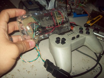

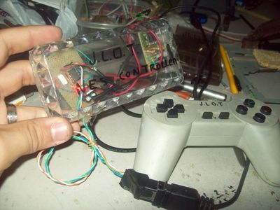

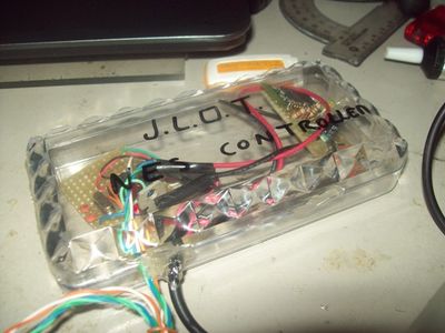

Step 5: Assemble!
Now you just need to burn the PIC, connect the BT board and the controller, open the virtual keys software and the NES emulator and play!
Here you find some more pictures.
