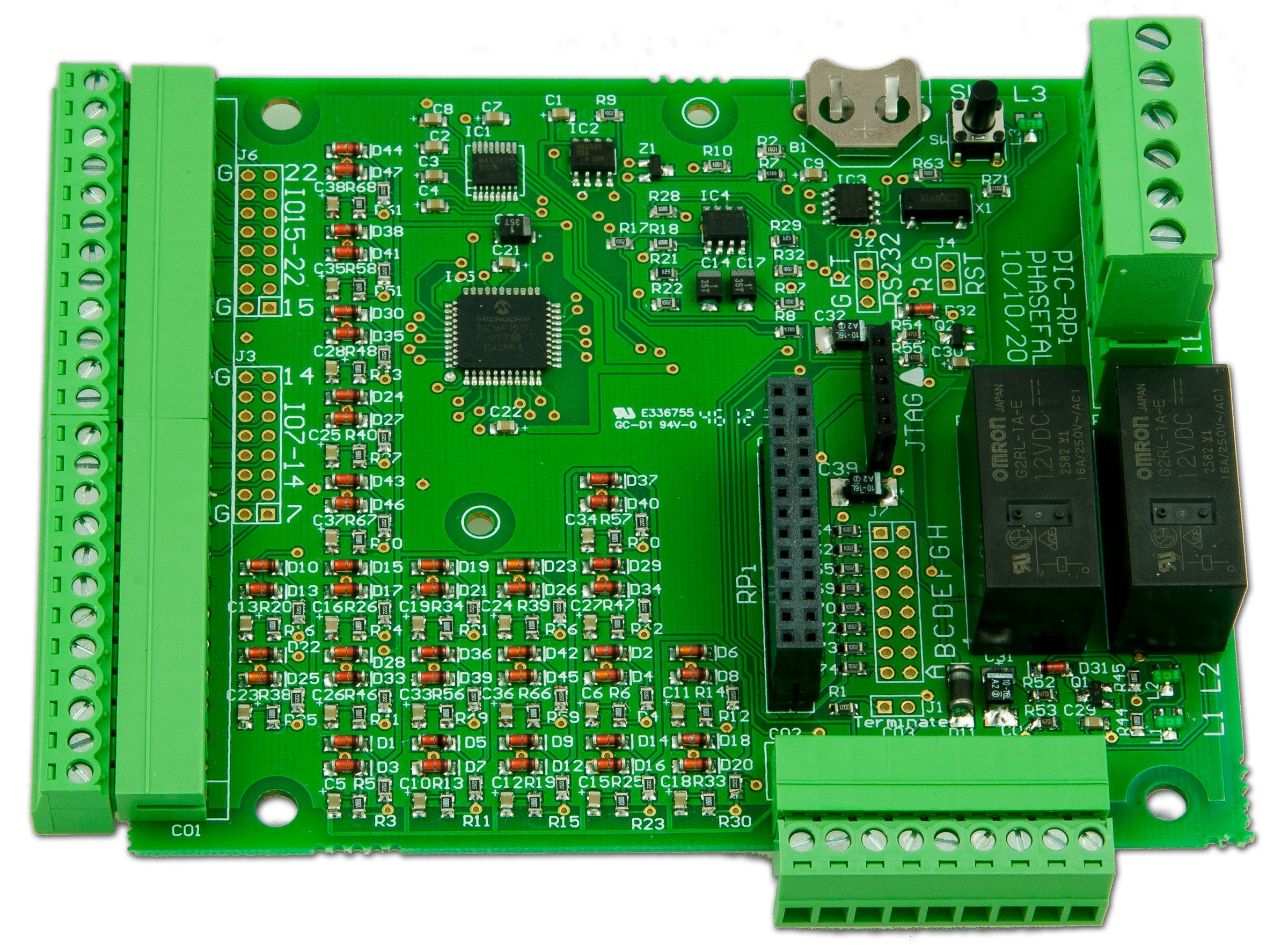

This is a module attached to the PIC PI which is an affordable open source software and hardware expansion board suited to home automation if you are interested visit our website
you can purchase the PIC PI expansion board from our website
