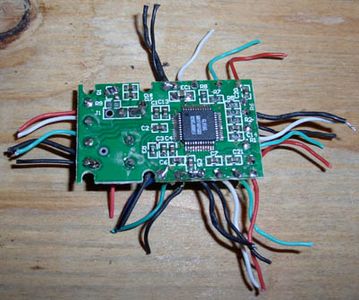

Step 2: Lets Have a Look at the Circuit Board
Once you have the circuit board alone I went and made a drawing of each set of wires so I can later look an solder the wires up correctly to the fingerprint scanner. It is very important to make sure the wires are correct otherwise you risk frying the attached devise by wiring the positive to the negative or to one of the data points.
Once you have the layout of the wires I used the instructions here to wire the hub interantlly so it wont use one. I want to give a big thank you to the user that posted that as it was very helpful for this project, and future potential USB add-on's.
Once you have the hub installed we can continue on to the fingerprint modification.
