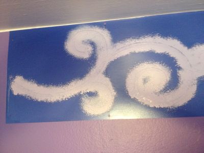

Holding the stencil brush straight up and down, tap it into the paint on the plate. Tap the brush onto the paper towel to take most of the paint off of the brush.
Bounce the brush onto the stencil repeatedly until the color is as heavy and opaque as you want it. I was painting a nursery, so I went fairly heavy. If I was painting a formal room, I’d probably go for something a bit wispier.

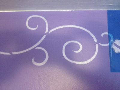

Carefully peel the stencil away from the wall without smearing the wet paint.
Line the stencil up for the next image by placing the left pair of registration holes in the stencil over the right pair of existing pencil marks.
Use your pencil to mark the two holes for the next image.
Dab paint onto your brush and dry the brush on the towel.
Pounce the brush over the image until it is about as opaque as the previous one.

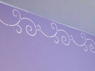

Repeat until you get to the end of the wall.
You are going to start at the center of the wall and move to the end of that wall in one direction. Then go back to the center and work toward the far side of that wall. I was able to place my step ladder so I could paint two images without moving the ladder, but it's still a lot of up & down the ladder and moving the ladder.

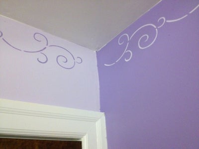

Step 9: Once More Around the Room.
After all the paint has dried, go around the room with an eraser to get all the pencil marks off of the walls.
