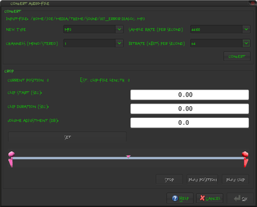

Step 6: Ringtones!!!
I'm assuming you've already cut up a song to use as a ring tone, if not, use a sound editor to cut the song to about 25 seconds. (verizon cuts to voicemail bfore the 25s it up)
open bitpim and click media > ringers in the side panel.
click the add ringer button (the two eighths notes with a plus sign)
select your file
set is as mono (it only has one external speaker, and it will save more space for better quality)
select the sampling rate (44100 is good, for smaller size go lower)
select the bitrate (64 is good, go lower for smaller size, quality will suffer)
click convert, and if you need, cut it further or make it louder
click ok
click Send phone data (the phone with the arrow pointing to it)
check ringer and select Add
click ok.
wait.
reset phone.

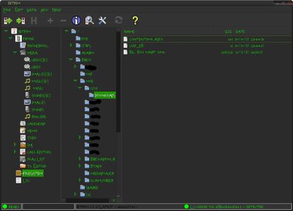

Step 7: Backing Up Vcast Videos.
Warning: this step take a very long time even for small files and accesses you phone's filesystem (but doesn't write), which is inherently dangerous.
follow these instructions very carefully and you should have no problem.
click view > view filesystem click on filesystem
click filesystem on the sidebar
navigate to /brew/mod/12513/downloads (the numbered folders may be different)
you should now see some videos (.wmv, .asf, .3gp, .mp4)
right click one and select save.
wait.
wait more.
this could be a while.
while you wait, why not look at some of my other fine instructables?
choose where you want it saved and click save.
if you're in ubuntu linux, make sure you don't save it in the root desktop, instead of your desktop! (at first i thought it didn't save, but then i saw it save three times in the wrong folder!)
you can also put it on your memory card.
to do that
first rename it to .3gp or .mp4 (the media player won't show .wmv)
and save it under my_flix

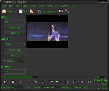

Step 8: Other Stuff You Can Do....
This has nothing to do with the cable but i thought i'd show you anyway.
Add your own videos:
download avidemux,
open your video
select xvid4 as the video format
click configure
select a bitrate (single pass quantizer)
under motion/misc uncheck 4mv
set number of b-frames to 0
and uncheck everything under b-frames
don't mess with the quantization unless you know what you're doing. (like me!)
click ok.
click filters
add mplayer resize and set it to 240x192 (nothing larger will work well)
add resample fps and set it to 15 fps (nothing higher will work well)
hit close
set audio to faac
click config and set the bitrate (56 is okay)
click filters
resample it to 44100 hz
and mix it to mono
hit ok
set the format to mp4 and save it.
copy it to my_flix and enjoy.
