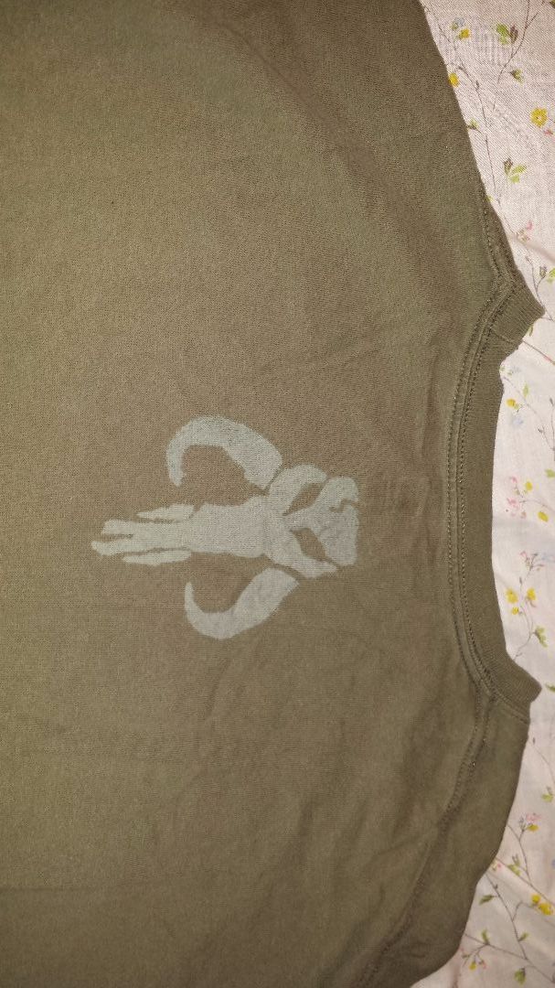

This is my first shot at bleaching decals, I am using cut vinyl for a stencil so there is very good adhesion to the material. Really had a lot of bleeding out on all of the edges. Did I get the material to wet?
Reply 5 years ago on Introduction
That would be my guess. It needs to be a mist.
