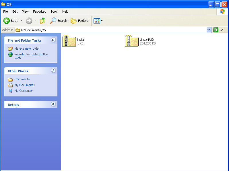

Step 1: Download the Necessary Files...
You are going to need to download the operating system before you use it, obviously.
You can get the files from here:
Pud Linux:
Download PUD Linux
Pud Linux Correct Install Batch file( ! required ! ) I cannot seem to upload a valid link so I will just have you save it later:
Once you have the files downloaded, continue to the next step.

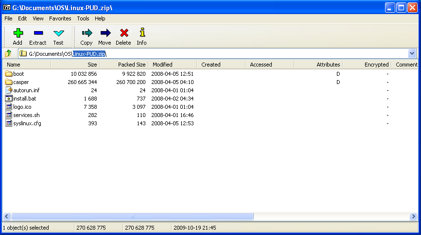

Step 2: Extract...

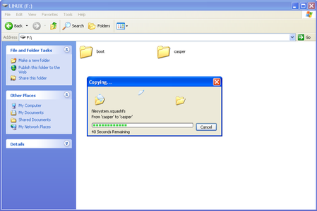

Next, once you have downloaded the necessary files, extract them to the root of your flash drive (normally F or G).
When I extracted it using the windows extraction wizard, It froze every time. So I used 7-zip.

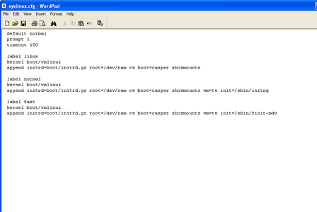

Step 3: Edit the Config File(to Change the Language)
The next step is to change the config file so it doesn't boot in Taiwanese, but if you also speak that language, then that's okay too. Start by going to the root of your drive, there should be a file called "syslinux.cfg", but Microsoft outlook will recognize the file type. Right click it and open it with notepad or wordpad.
There should be 2 parts that looks like this:
kernel boot/vmlinuz
append initrd=boot/initrd.gz root=/dev/ram rw boot=casper showmounts wm=tw init=/sbin/finit-mdv

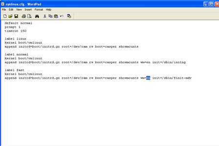

Where it says wm=tw, change it to say wm=en
Then your config file should look like this:
default normal
prompt 1
timeout 150
label linux
kernel boot/vmlinuz
label normal
kernel boot/vmlinuz
append initrd=boot/initrd.gz root=/dev/ram rw boot=casper showmounts wm=en init=/sbin/initng
label fast
kernel boot/vmlinuz
append initrd=boot/initrd.gz root=/dev/ram rw boot=casper showmounts wm=en init=/sbin/finit-mdv
If it doesnt, change it so it does. But if it does look like this, your ready for the next step, making it bootable!

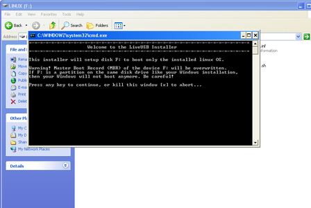

Next, save the document in the root of your flash drive. It should be saved as "install.bat"
Next you are going to need to make it bootable. You need to be an admin for this step.
Go to the root of your flash drive and double click "install.bat"
For vista users, right click it and select "Run as Administrator"
It should confirm that it will make your flash drive bootable.
Warning:
Check to see if it is the right drive letter! You don't want to screw it up!
For the last time, do NOT try it on your hard drive, it will make windows UNBOOTABLE!

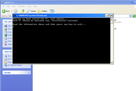

Press any key to make it bootable, it should take less than 3 seconds.
It should display a completed screen. If not, something went wrong. Make sure you are an admin, or it will say "Access Denied" or some other error.
