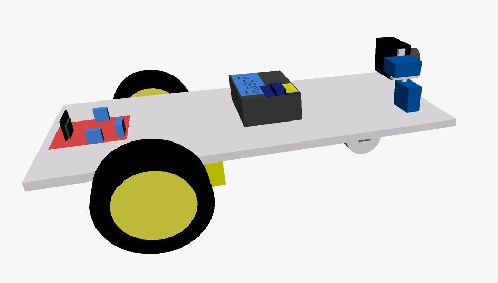

Introduction: How to Build 433 MHZ RC to Control Servos (100% Arduino)
Hi guys!
There is my workaround to bypass timer issue (servo and virtual wire librairies).
Because of the timer issue I had, I decided to bypass it by adding a third arduino.
There is the way it works:
- The transmitter checks inputs and send a number.
Example: send "1" if pin 1 is HIGH and send "11" if pin 1 is LOW. Send "2" if pin 2 is HIGH and "22" if pin 2 is LOW
- The receiver reads the received code and sets equivalent pin to HIGH or LOW depending the code.
Example: receiving "1", so put pin 1 HIGH. Receiving "11", put pin 1 to LOW.
- The 3rd arduino sets servo's position depending the input pin.
Example: pin 1 is HIGH, move servo to the left. If pin 2 is HIGH, move servo to the right.
What do you need:
Transmitter's side:
1 arduino board (smaller is better, but after all, size doesn't matter !)
1 RF 433 MHz transmitter
1 2-axis joystick
Receiver's side:
2 arduino boards
1 RF 433 MHZ receiver
2 Servos
I hope it will help someone!
Contact me if you have questions!
