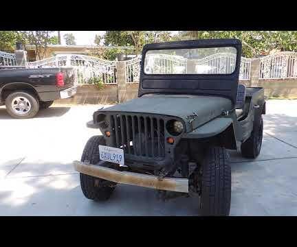

This build is a 1942 Ford Jeep. I like the look of these Jeeps and thought it would make a neat EV for local driving. It is not very aerodynamic so this vehicle would not make a good vehicle for driving on the freeway or at high speeds. This is a 72 volt EV which includes 6 - 12 volt Lead acid batteries. I wanted an older vehicle without power steering, power brakes and as simple as possible to work on.

Step 6: Mock Up, Pre-Build and Order the Parts
I gave you my list of parts and yours will be similar as most EV’s will have the same basic parts. You probably will have a different motor and so on but you will have a motor. Now that you have your list of parts you should mock up where everything goes. You should find out the size of your parts and use that to help with the mock up. You need to know where everything goes so you can order the right amount of wire. Setting up the engine and transmission may be important but the space used is normally less than the automotive engine. You will need to find a space to fit the batteries. You will want to make sure the batteries on your parts list will fit. Some people will use the back seat others will fit it in the engine compartment. Some choose to use the lithium batteries as they use less space for the same power. The reason you should mock up your EV at this time is to make sure everything will fit and you have a place for everything. If you want to build a 144 volt EV with 12 Deep Cycle batteries and you want to fit it in a Smart car, good luck finding the space. I have seen people use cardboard to do this or you can draw out all the parts and your EV on paper to see if everything will fit.
At this time you will need to de-ICE your vehicle. De-ICE stands for the removal of the internal combustion engine (ICE) and related components such as tail pipe, radiator and so on. This was already done for me so I had nothing to do. Think ahead when you do this. You probably will want to keep many components as they are needed on your EV also. The transmission, horn brakes lights and so on will need to be saved. Remember that if you have a simple car that does not have power brakes and power steering you will save some time as these components take special consideration and knowledge/research.

Step 7: My Biggest Mistake.
This build was a live and learn, I want to mention my mistakes so you can learn from them. The first build was a custom transmission and it would have worked if I had a more powerful motor. I think I still would have rebuilt it the way I have it now because the new build is so much quitter and have fewer parts that can break. A picture speaks a thousand words so look at the picture of the original design vs the new design. Like I said the original designed worked but was louder and the motor was too small. I increased the size of the motor and went to a drive shaft shop who built the driveshaft to my exact specifications. The Inland Empire Driveline Shop was very knowledgably and also advised me to add the adjustability to the drive shaft. This allows the motor to be locked in place and the rear-end to move up and down and the drive shaft can absorb the slack (pretty cool). Like I said my biggest mistake was the motor size, it was just too small. It got very hot after I used it and eventually heated up so hot that the solder was spitting out of the motor and the motor seized up.

I wanted the motor in line with the yoke on the rear-end. I used a string to try to make this a strait as possible. This was not that simple, I had to put the motor in place many time during the mock up to get this right. I welded new motor mounts and place it in the vehicle. I put the motor in place and attached it to the motor mount. The new motor was very heavy so I had my boys help me lift it in and out of place. Once the motor was placed I added the driveshaft and that’s it for the mechanical components that I added. I also fixed the brakes and did some other maintenance on the Jeep, it was originally built in 1942 so it needs some TLC.
