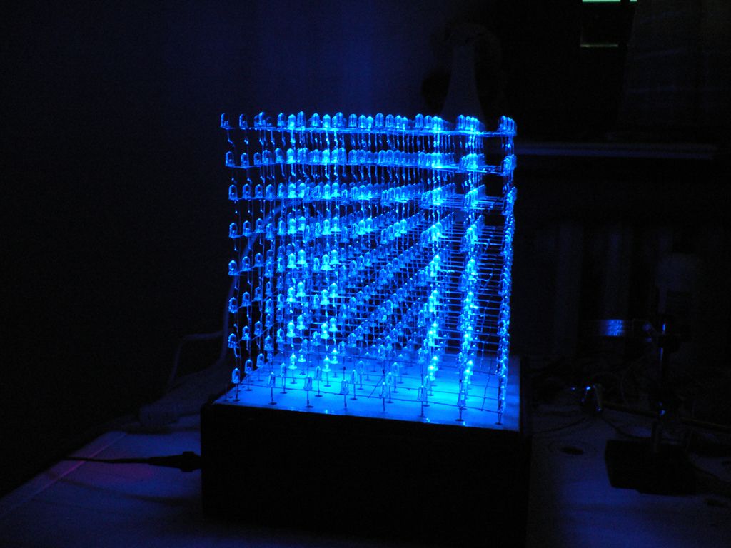

How the cube is made:
The dimensions of the cube will be 8 led by 8 led, by 8 led, for a total of 512 leds. The whole structure will be based on a wood board.

The finished cube functioning.
