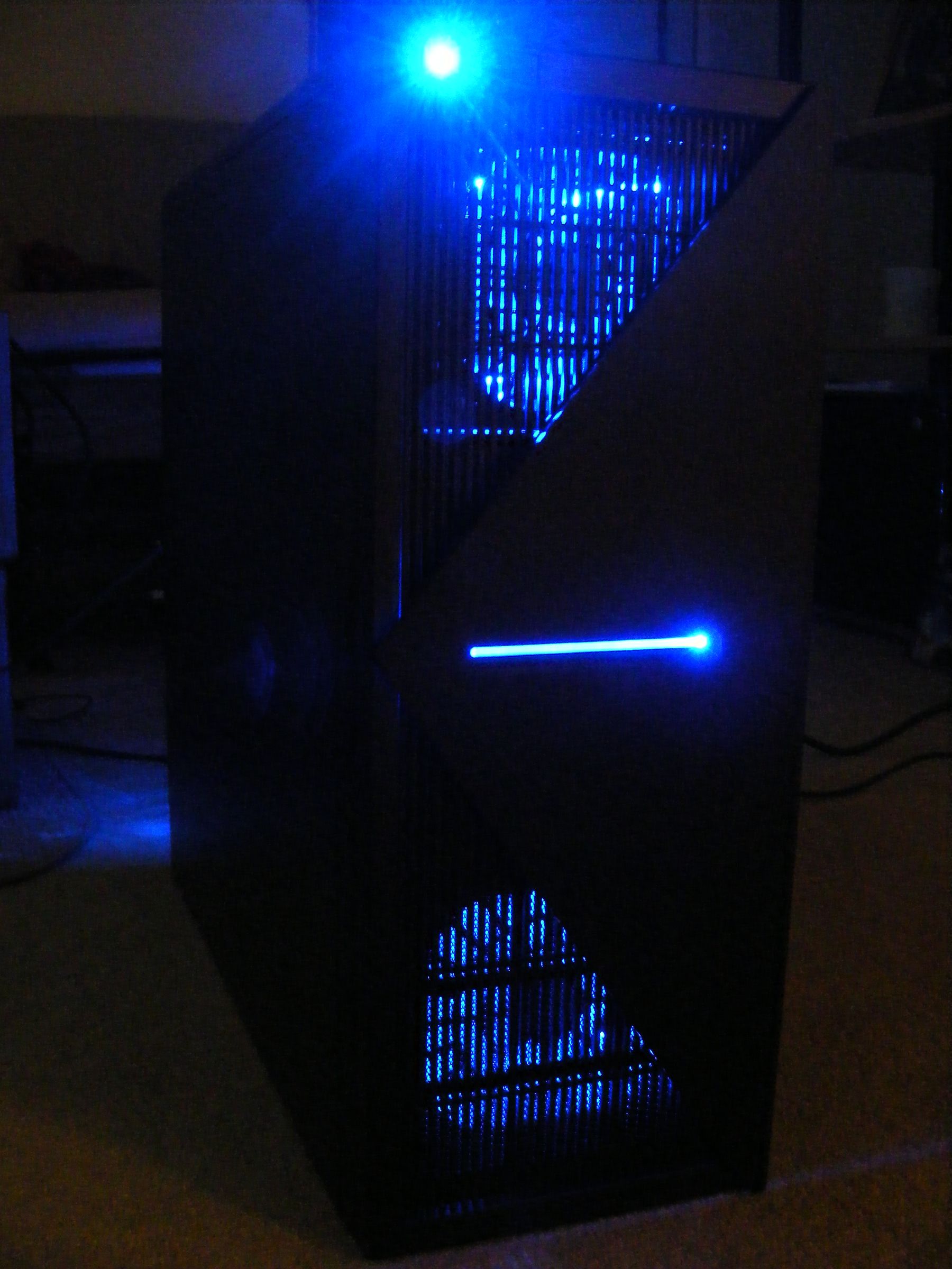

PC Case Replacement
A PC doesn't need to be contained in a case, some people prefer them mounted on what's called a torture rack, if you haven't seen one, basically it's a small shelving unit consisting of 2 shelves, mounting the motherboard and everything directly attached to it, on the top, and mounting the rest on the bottom shelf. Well, you can also use a standard motherboard tray... much cheaper than buying a torture rack, but it lacks the ability to mount hard drives and the other components onto it, but with some tweaking and modding it could become one heck of a setup. Plus this is cheaper than buying a case anyways. For a site to buy a motherboard tray, check out: Performance-PCs.com.
UPDATE: Check out my current setup below, pictures 9 and 10.
