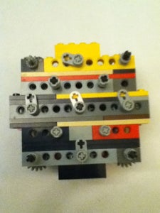

Step 2: The Frames
The frames that I made were constructed out of any beams I could get my hands on so it's not exactly symmetrical.  These frames hold all of the axles and gears in place, so just make sure you have certain holes available (Look at the annotations).
