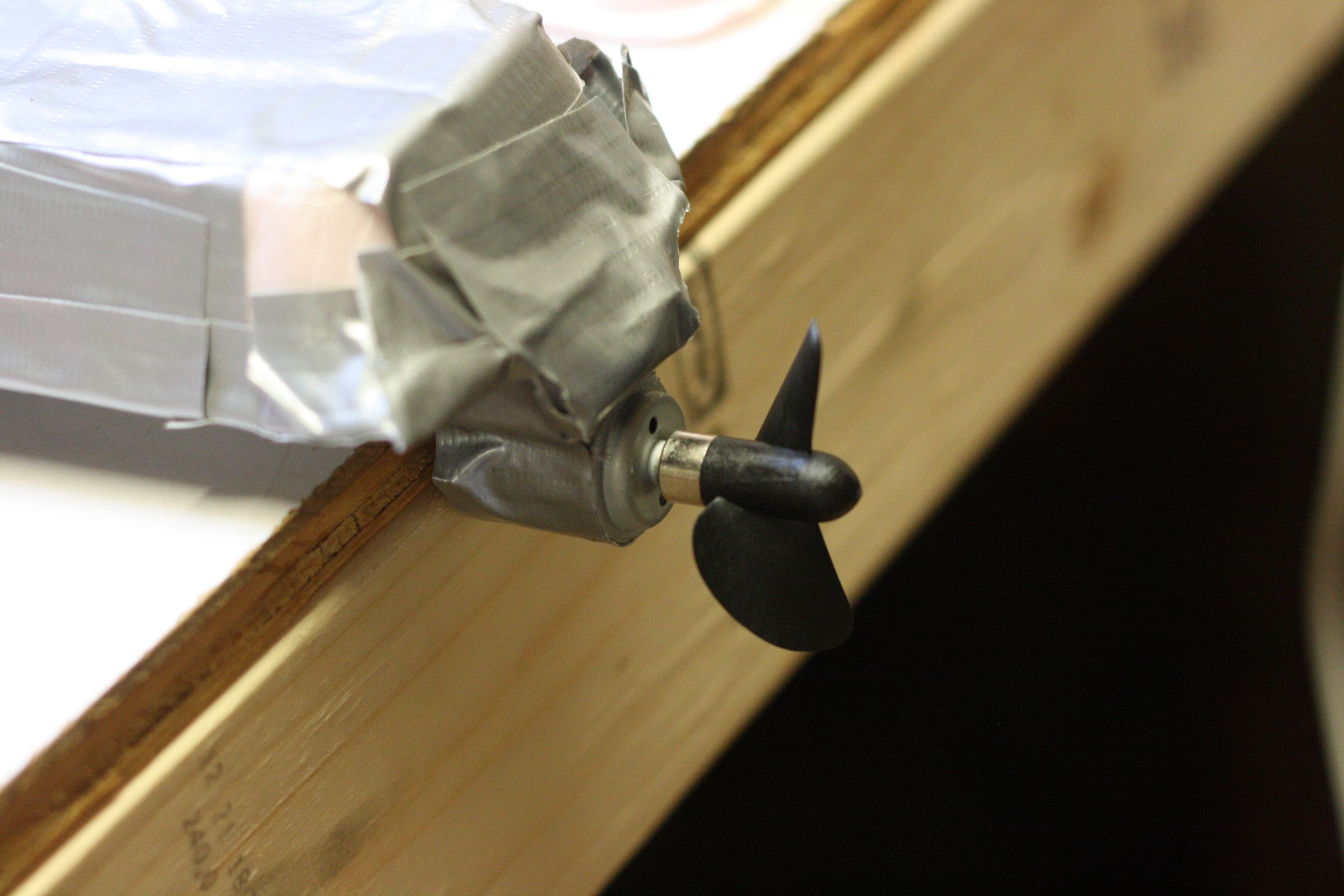

Step 3: Adding the Motors
Next, add the motors to it. I used two mini super cub rc airplane motors for forward propulsion and 1 radio shack motor for up and down movement. All of the motors are 3 volt motors. First, measure out the middle of each of the 12 inch sections on the back of it. Then, take your Dremel and cut out small 1 and 1/2 long sections in some PVC. Then, shape out a curved part that will attach to the frame. Use hot glue to attach them to the frame, then hot glue the horizontal motors to them. (Do this to the other motor on the other side) Then use your Dremel to cut out a small section on the top vertical motor bar for the motor to fit into. Then, drill a hole into the end of the pipe. feed the motor into the Dremel hole, then feed the wire through the pipe and out the wire hole. (Don't seal the hole because you will want water to be able to come out and in. Hot glue the motor in, then attach all of the propellers to the motors. Make sure that the motors can run freely without something binding with the shaft.
