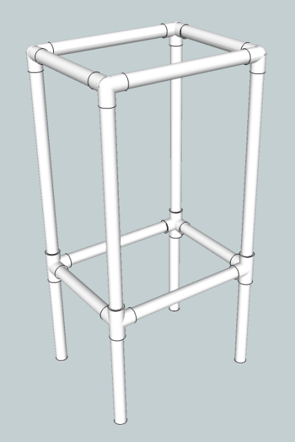

Step 2: Design
I designed the gate in Google SketchUp, using the PVC components available from Formufit here. I built it with a 32” doorway in mind, as that is what most of mine are.
In order to accommodate for larger doors, you will need to add another ‘T-Section’ (or more than one) for an additional 5 inches in width. An example is shown below in one of the SketchUp diagrams.
To accommodate for doors between 33” and 37” you can increase the parts that connect to the wall by an inch on each side, but do not go over 2” or you will make the span between the frame and the doorway more than a 3” gap, which is not recommended under ‘baby gate standards’.
I’ve made the Google SketchUp plans for the baby gate available here on the Google SketchUp 3D warehouse. Feel free to modify/customize them as you need.

Step 5: Assemble the Top
IMPORTANT: I chose to use 3/4” wood screws to keep the pipe and fittings in place. I drill a small hole into the fitting, where it meets the PVC and use a Phillips bit to put the screw into place. It is just as strong as PVC Cement, and the friction of the pipe into the fitting keeps it together anyway, and you can avoid the noxious odor and other concerns that come with PVC cement. Also, this way you can perform a ‘dry fit’ of all of these items and then attach screws or do it one at a time, your choice.
I like to use a countersink bit attached to the drill so that it makes a nice indentation for the screw head to go into. It keeps in clean and won’t allow snagging of clothing or little fingers.
I do use PVC cement for a couple of items later.
Should you choose to use PVC Cement, remember: PVC CEMENT ESSENTIALLY MELTS THE PVC TO MERGE THE PIPE AND FITTING TOGETHER, IN ABOUT 30 SECONDS, SO MAKE SURE THAT THE PARTS ARE LINED UP AND GOING IN THE RIGHT DIRECTION WHEN CONNECTING THEM.
We’ll start assembling the top of the gate. For this you will need two (2) 90 degree fittings, five (5) tees and 6 (six) pieces of the 3” plumbing grade PVC segments.
Simply assemble the fittings as shown in the diagram below, with a 90 elbow first, followed by the four tees using a 3” Plumbing Grade PVC segment between each fitting, then another 90 elbow. You’ll put another tee facing outward off of the final 90 degree fitting.
