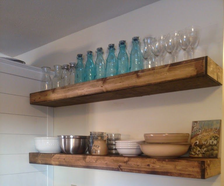

Introduction: How to Build a Simple Shelf Bracket
Often you want to put up a shelf, but unfortunately, the metal brackets just aren't that pretty. I'll show you how to build these simple brackets for a 12" shelf. You can use this method with 2 x 4's for large shelving in the basement or garage as well.

Step 12: Installing the Brackets.
Use a stud finder to mark the studs in the wall or use heavy duty dry-wall anchors. I mounted 3 of mine into studs, but the last was an anchor because of the ugly hose box behind the washer.
Step 13: Adding the Shelf.
Once they are on the wall you can install the shelf by just screwing some 1 1/2″ screws from the bottom through the brackets and into the shelf board. The next time I paint something white, I’ll paint over those screws, until then, just ignore them
