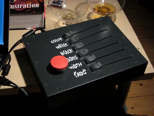

The Tagtool controls consist of 6 faders and a pushbutton. The pushbutton releases a drawing so the animator can move them with the gamepad. There are detailed instructions on how to use the controls here.

Step 5: Tagtool Mini
Congratulations, you finished your Tagtool Suitcase. Next you will need to install the Nodekit software on your Computer.
If you need things to be more compact, or if you don't want to open up your graphics tablet, the Tagtool Mini will be a good alternative. For this you can use any case that has enough space to hold the Arduino, the faders and the pushbutton . You just have to connect the graphics tablet externally.
