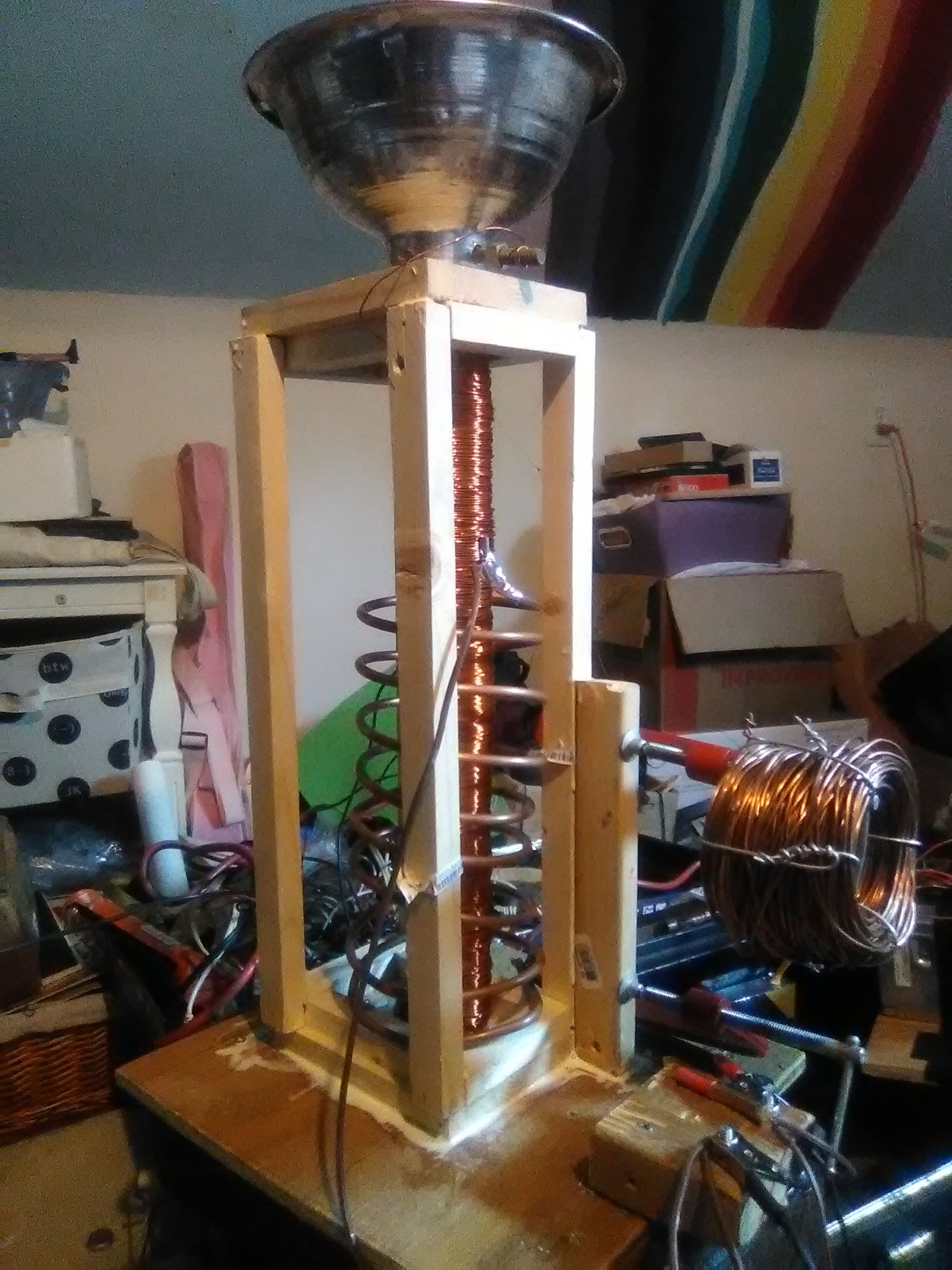

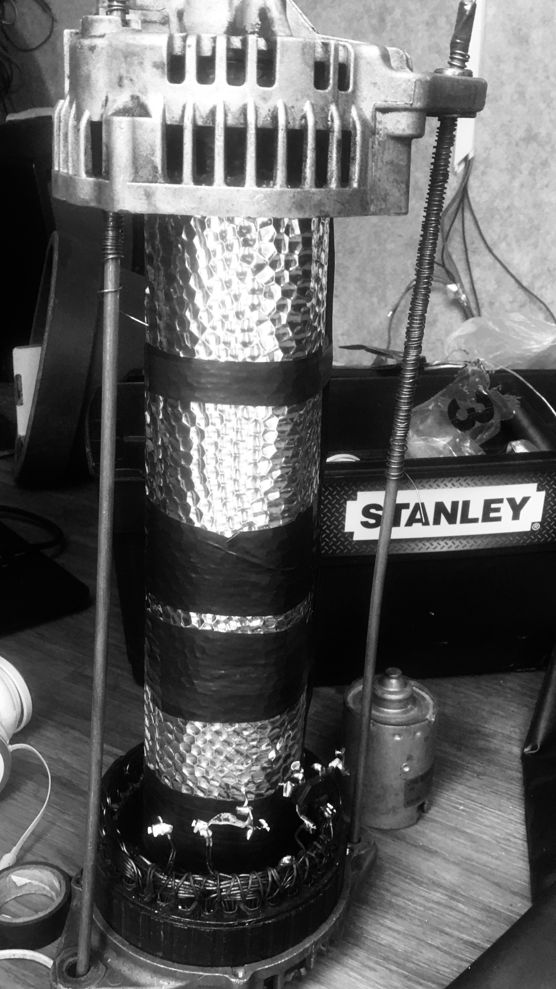

Step 3: Wind the Secondary
Put a small slot into the top of the pipe to wrap one end of the wire around. Slowly and carefully begin to wrap the coil, making sure that you don't overlap wires or have spaces. This step is the hardest and most tedious part, but taking a lot of time will yield a very nice coil. Every 20 or so turns, put a ring of masking tape around the coil to act as a barrier if the coil starts to unravel. Once finished, wrap a tight piece of tape around the top and bottom of the coil and spray it with 2 or 3 coats of enamel.
Tips:
  • I built a rig for winding my coil that consisted of a microwave turntable motor (3 RPM) and a ball bearing.
  • Use a small block of wood with a notch in it to straighten the wire and tighten the coil.

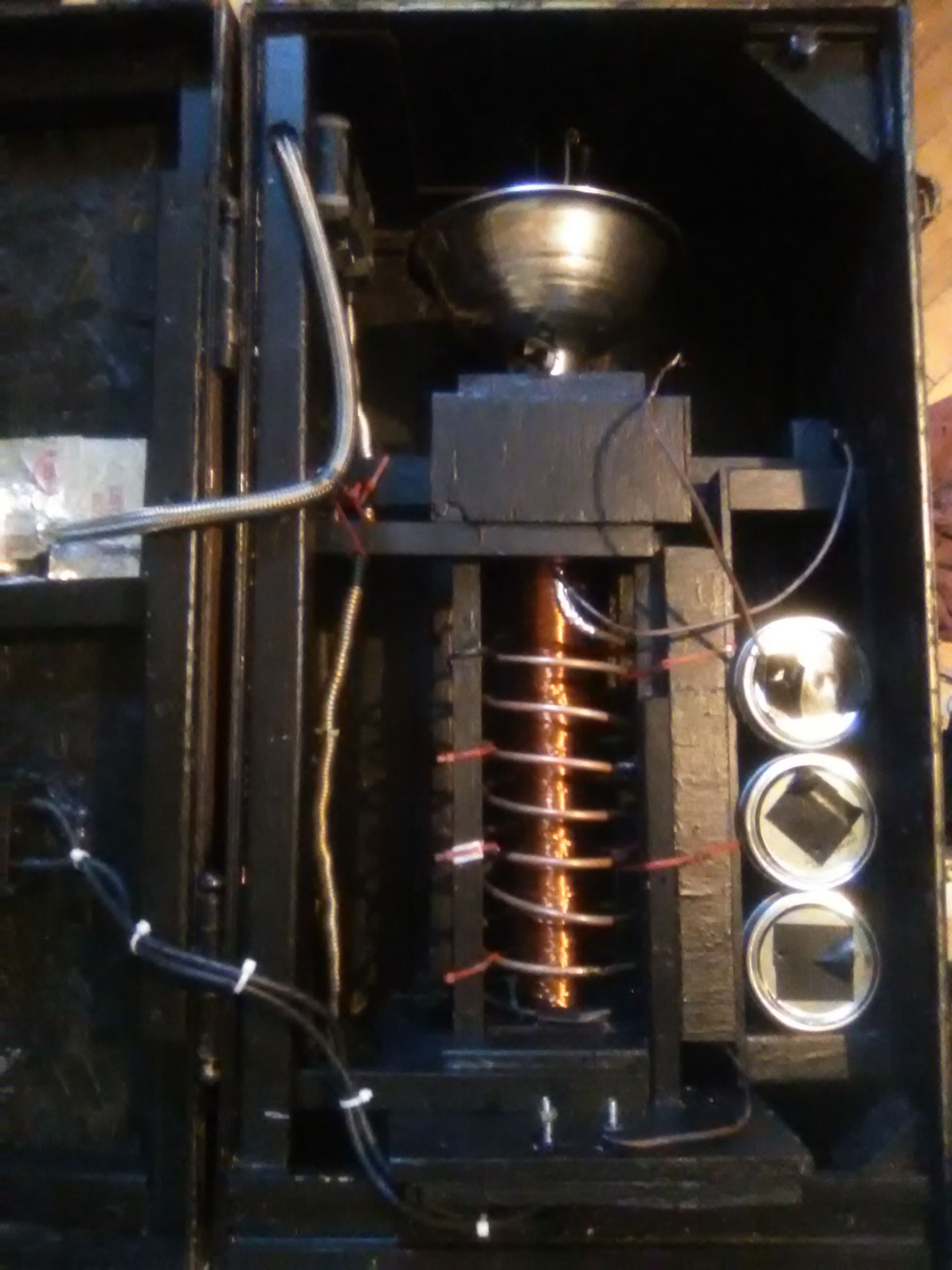

Step 4: Prepare the Bases and Wind the Primary
Align the metal stand in the center of the bottom board and drill holes for bolts to go through. attach the bolts tightly upside down. This will allow you to put a base for the primary on top of it. Then bolt the primary's base in. Take your pipe and wind it into a pretty upside down cone (not the flat spiral in the pictures). Then mount it on the supra-base.
Optional was the addition of 2 supports that I zip-tied the primary to.
Forgot to add how to make the spark gap! It is just two bolts in a open-air wooden box, and they are adjustable for tuning, etc. See the last image...

Step 6: Connect Everything
Wire up everything according to the schematic below. The secondary's ground CANNOT be put to mains ground, it will fry everything in your house.
My Coil's Specs
  • 599 Wraps on secondary
  • 6.5 Wraps on primary
Step 7: Start It Up!
Bring it outside for it's first run, as it really isn't safe to run anything this potentially powerful indoors, there is a high risk of fire. Flip the switch and enjoy the light show. My NST, at 9Kv at 30mA, makes the coil give off 6 inch sparks. See it below:
