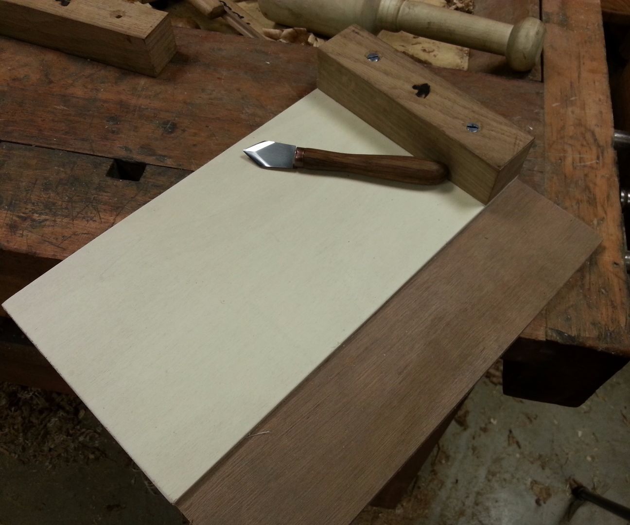

I once heard a great craftsman say that a good joiners work with a sharp pencil, but great joiners work with a marking knife. I put this to the test and can honestly say that it has worked for me. So I'll describe the use of it here.
Using the marking knife, scribe a line all around the far end of one of your planks. If the cuts don't line up, you did something wrong during the dimensioning proces. It is up to you if you want to go back and take care of it.
Using a chisel and a mallet, we are going to deepen the cuts a little. Put the bevel of the chisel in the groove and give it a few taps. Move the chisel sideways, and repeat. Now put the chisel on the waste side of the board at an angle, and chop down towards the cut. This will create a knife wall, which will help guide the saw later.
With a bench hook and a backsaw (or tenon saw, depending on your geography), make a square cut but leave a bit of wood between the saw and the knife line. We are going to use a shooting board (see photograph above) and a handplane to make a perfectly square edge. Hold the board firmly against the shooting board while you creep up to the knife line, using a shallow cut on your handplane. I used a Stanley no. 4 here.
Repeat this for all ends. If you stack the boards on top of each other, they should be the same size. Your fingers are able to feel differences up to one thousands of an inch. Make sure you don't feel any.

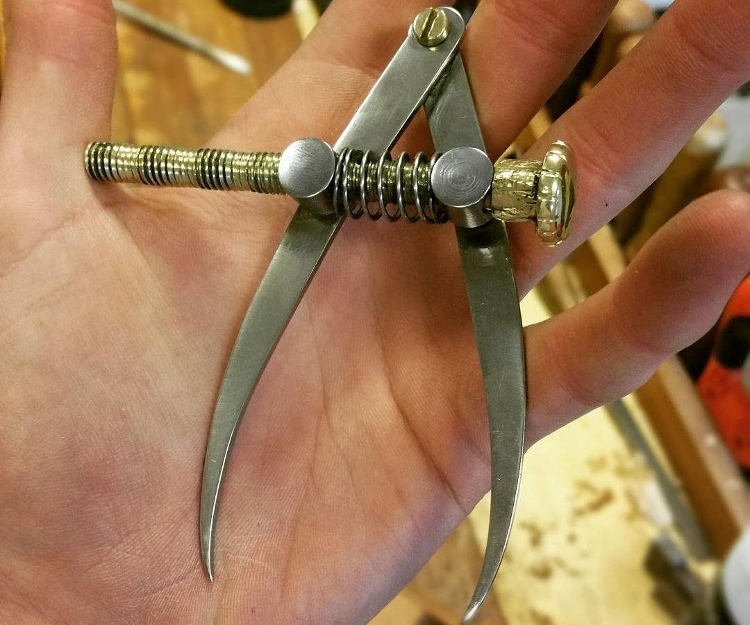

With a marking gauge, scribe the thickness of the lumber around the edges of the planks. With a compass, square, bevel gauge and marking knife, lay them out as well as you can. Cut the dovetails with a backsaw. A gents saw might be used if you are not comfortable with using a tenon saw. Leave the tails a little beefy, and use a sharp chisel to pare the joint down to the line.
