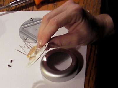

Step 5: Remove Cover
Once the cover is loosened, carefully pop it out. Remove the lens and reflector, and set aside. You'll need these parts again soon.
