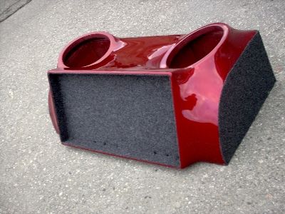

Step 10: Adding Ports
After putting the box in the truck i decided i wanted to port it...
So i bought some ABS pipe and a hole saw set.
Since the box is already built we can measure the air space pretty easily by either measuring with a tape measure and doing some math or the easy way and fill the box with packing peanuts and take that amount and fill up a square cardboard box, this will give you an accurate and easy way to calculate the air space.
Use an online port calculator to determine the length of the port needed for your enclosure
I cut the ABS to length using a band saw and then drilled out a whole in the box with a hole saw the size of the inside diameter of the ABS, then i cut a ring to accommodate the outside diameter of the ABS pipe and it will butt up to the hole cut into the box (see picture above)
Step 11: Paint or Wrap
Last step!
You can paint it your favorite color or maybe wrap it in vinyl, carpet or both like pictured above...
