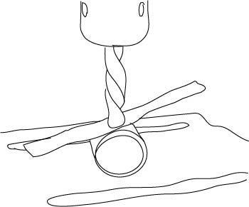

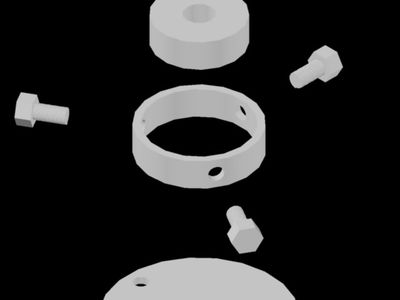

- The first three holes will be drilled into the collar. I recommend using a compass set to divide the sections evenly using the same radius as the collar perimeter. Draw the circle on a piece of paper and then "walk" the compass around the perimeter, making a mark at each stop. This will divide the circle evenly and all you have to do is transfer the marks using a square.
- These holes must be drilled (size to allow 1/4" tapping) perpendicular to the steel cylinder. Balance a steel ruler on the cylinder at the drill point and bring down the Drill Press (Turned Off). If the drill is in the right alignment the steel ruler will be parallel to the drill table. If not, the ruler will be forced left or right. If it goes right, move it right. If it goes left, move it left. Once aligned and adjusted, remove the ruler and drill the holes.

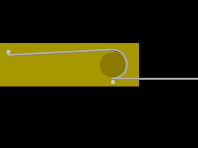

Step 3: Bend the Steel & DIY Jig
- Find some scrap wood (3/4" is best) that can hold the full length of the steel rod, and another piece of scrap to cut out a 6" circle.
- You are going to need some scrap metal pipe as well (1/2"D x 1" - 4" in length).
- Refer to image provided to construct the jig (see below).
- The pipe for the jig should be secured to the scrap wood by drilling a hole in the specified location the same size as the pipe; the circle of wood should be affixed to the scrap wood by screws.
- After the jig is completed, heat the section of steel (see image) with the rose bud or forge until it glows orange. (WEAR LEATHER GLOVES)
- Lock one section in with the pipe scrap and bend the rod around the circle until the other end fits into the other locking section.

Step 5: Tapping Holes and Final Assembly
- Drill a hole the same circumference as the 3' rod into the scrap wood base (or a bucket of well-packed sand works as well)
- Tap all holes needing thread using an appropriately sized tap for holes previously drilled.
- Taking your bolt, lock washer, washer, and bearing, attach the bearing to the rod.
- Next, attach the hero engine to the bearing by tightening the three bolts in the collar to the bearing. NOTE: Do not over-tighten or the engine will not spin.
