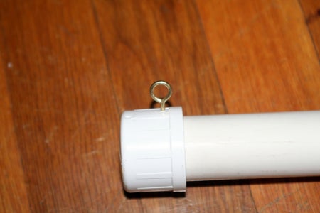

From this point on that end is the top end. Take a screw eye hanger find a drill bit slightly narrower than the threads of the hanger. Drill a hole through the side of the end cap and into the pole. Now thread the hanger into the hole so that you have something that looks like this:
Do this to each of your vertical poles.
