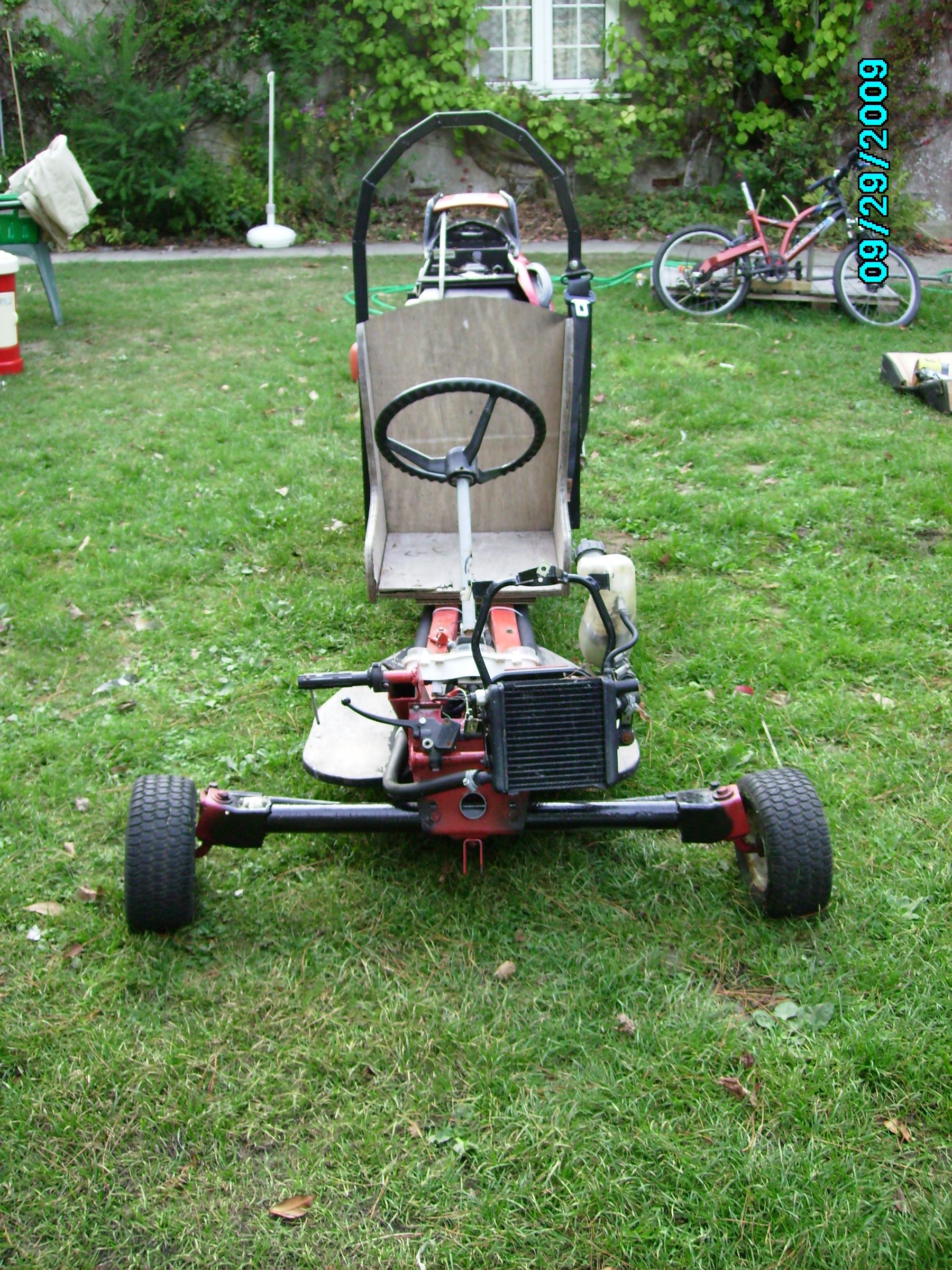

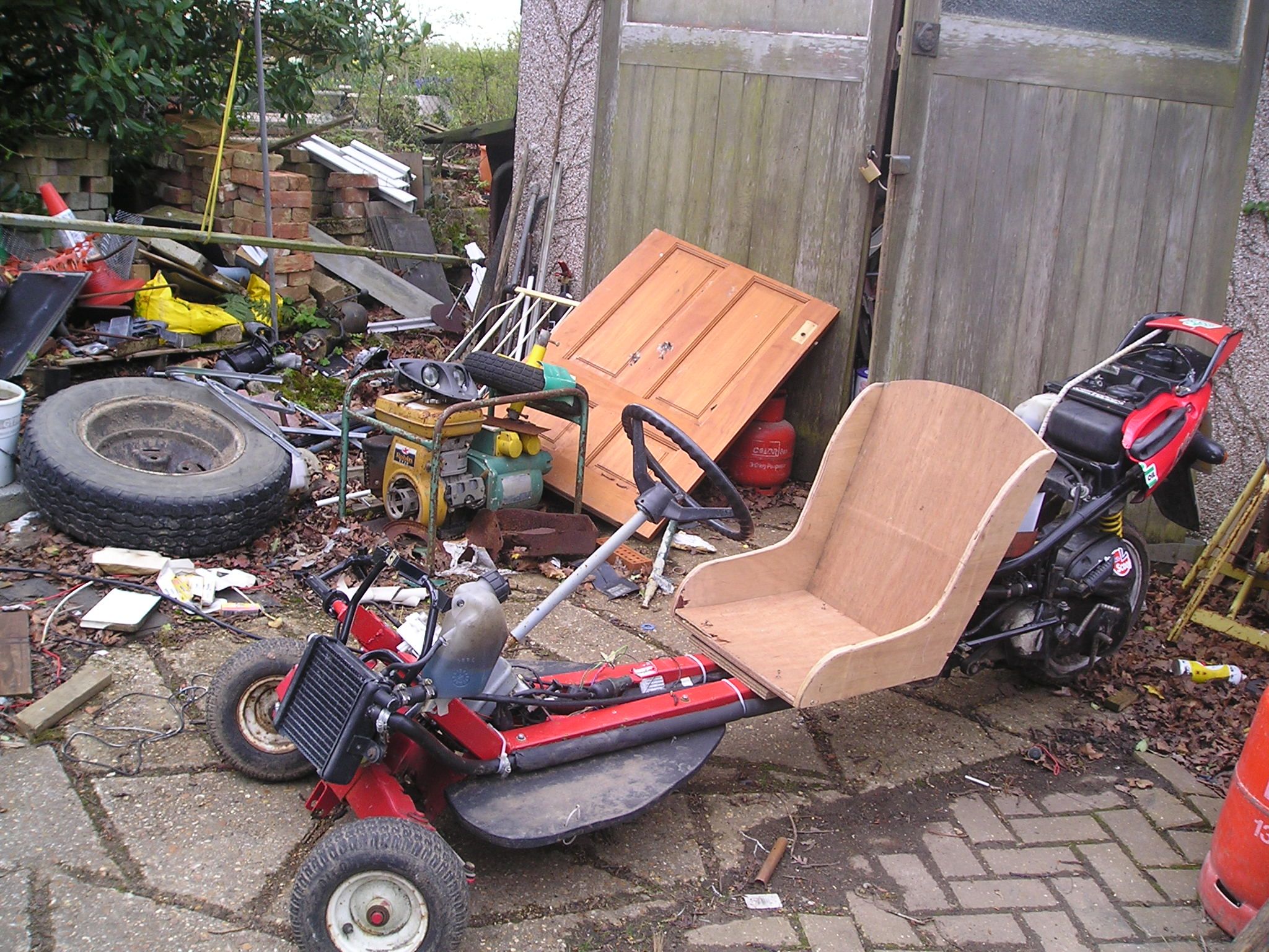

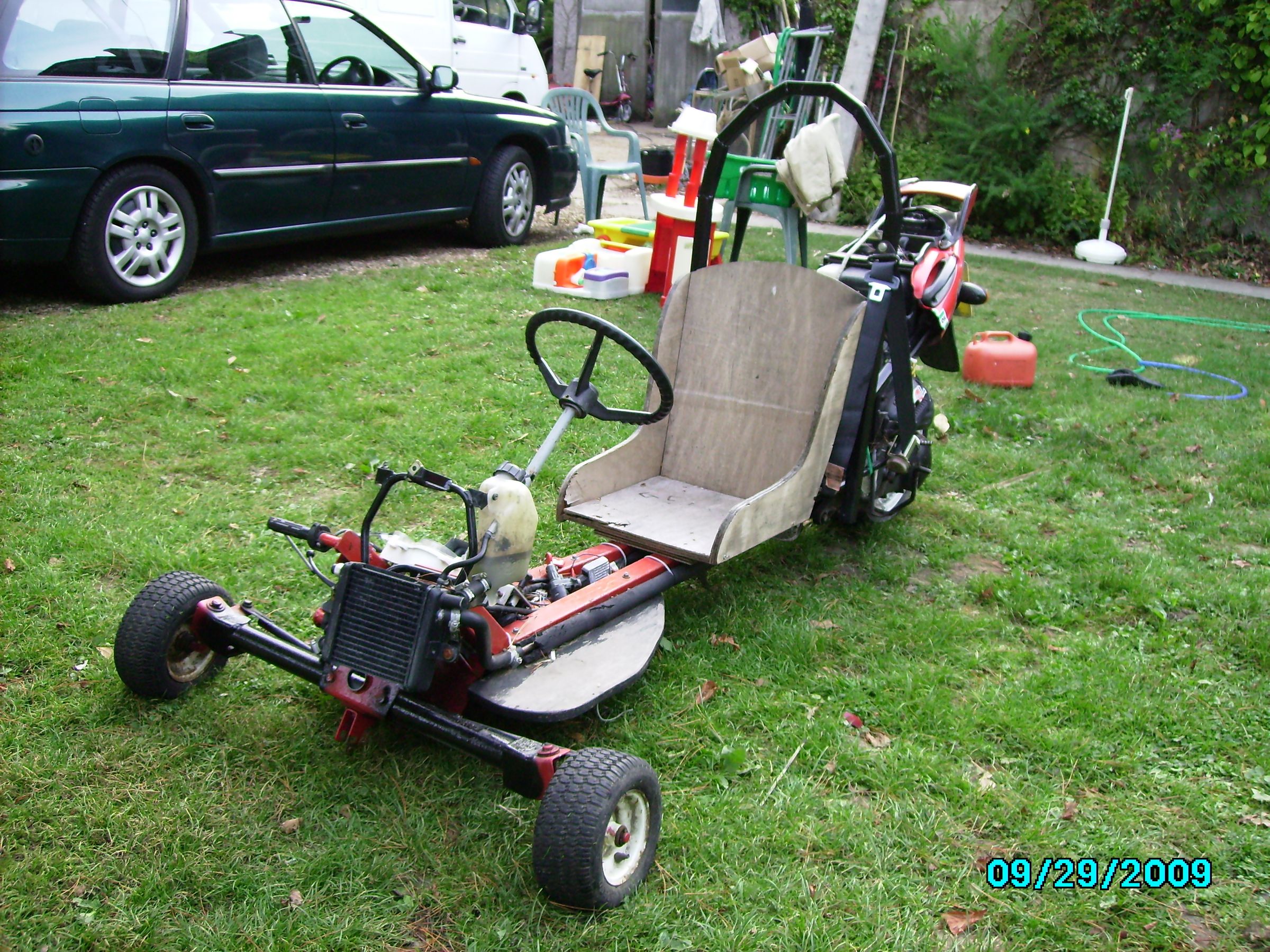

If you have seen my first instructable, you will know that I have built a go kart. Well, I found that when going round corners it flipped very easy and the seat acted as a sort of roll bar to stop it fliping over completely.
This dameged the seat and I thought I would build a roll bar to strengthen up the whole machine and to stop it from damaging the seat when it rolled over.
The roll bar consists of about 4cm by 4cm box section. These are the following tools you will need to build this:

To make the curve in the metal, first you have to cut out a small triangle shape in the box section. The pictures show all the measurements needed to cut out the triangle.
There should be 68cm at either end of the box section. When it is all completed, the overall height of the roll bar should be 95 cm, and the width should be 52 cm.

This step is quite hard as it involves a lot of thinking. The way I attached the roll bar onto my go kart was by welding a horizontal bar accross the bike half and then welding the roll bar to that.
This worked for me, but because there are so many different bikes this won't work for all of them. You'll just have to figure out how to attach it to your go kart.
