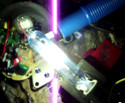

Step 4: The Finished Board
Pictures of the finished board. Some components are mounted under the transformer to save space
Step 5: The Finished Product
The circuit built into a lantern.
The first picture shows it starting and the second shows it on.
