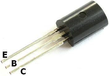

Step 4: Transistors Solve Our Problem - the Emitter Follower
It turns out that a good solution to this problem is a special circuit called an emitter follower. The emitter follower consists of input voltages (which may or may not come from the same source) at the base and collector of what we call a transistor, with output voltage (and our load, eventually) at the transistor’s emitter.
There are two main rules of thumb to know when working with transistors.
1. The emitter voltage will always be the base voltage minus a 0.6 V drop (which is for the diode that connects the base to the emitter.
2. The current from the emitter is always equal to the current from the collector, which is ABOUT 100 times bigger than the current from the base. (There are certain limitations to this: if the collector source can’t put out enough voltage to keep the current at that level, your load won't get the voltage you're trying to give it. Also, the voltage from the collector must always be about 0.2 V higher than the voltage from the base. Otherwise, the transistor will break.)
At first glance, the emitter follower seems like a useless circuit. Our output voltage is simply our input voltage, minus the 0.6 Volts we lose going through the transistor.
However, the emitter follower can be very useful in terms of “stiffening” our voltage source (i.e., reducing sag). Ideally, a voltage source’s internal resistance is minimal, and our load resistance is maximal. We can think of this as voltage sources “liking” loads with a big resistance and loads “liking” voltage sources with low internal resistance.
The factor of ~100 difference in current between the emitter and the base means that the resistance of our voltage source (which in our case is something called the Thevenin resistance of our voltage divider) looks ~100 times smaller to our load, which helps out with our sag issue!
Let’s revisit our previous example, but now using our emitter follower voltage source. Then Vout=Vin*(Rload)/(Rload+Rth/100)=15*(10)/(10+50/100)=15*(10)/(10.5)=14.28 V.
