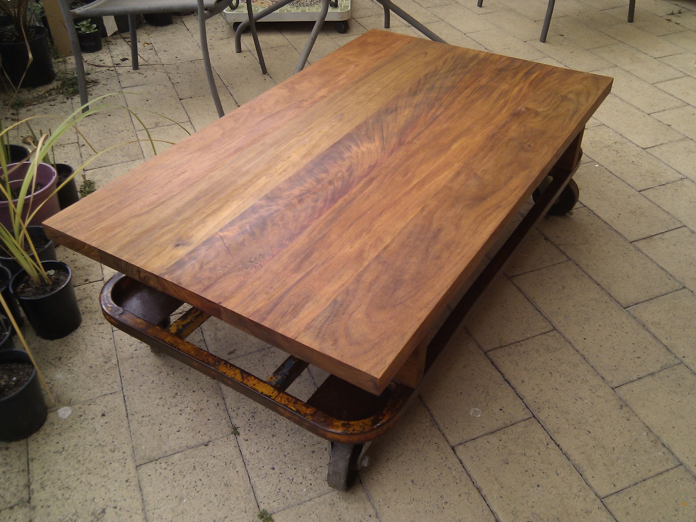

So, you've used matching wood filler for any little nicks in the wood and all the nail holes, sanded it all down and are ready to paint..
Go to the store, pick a product and follow the instructions on the tin ;)
I had some left over from the coffee table, so went and bought the same so that both pieces of furniture would match.
I did an extra layer of satin finish on the top surface to give it a little extra protection.
