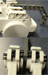

Step 2: The Arm
Take one of the arm pieces, two of the smaller gray couplings, and four of the large black couplings as shown in the top half of the photo.  Place the two gray pieces into the last two holes of the arm piece on the long side of the arm.  The gray pieces should have an even amount on either side of the hole. Place the four black couplings over the ends of the gray couplings with the crown side closest to the arm.  A finished product will look like the bottom half of the photo.

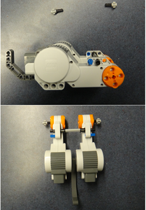

Step 3: The Chassis Part 1
Take the two NXT axles, the big gray coupling and two of the black couplings. The correct parts are shown in the top photo.  Connect the two black couplings to the end of the gray piece. This is shown in the top half of the second photo. The ends of the black crowns should be placed through the middle hole of the group of three holes on the axle next to the orange circle. The completed product for step three will look like product in the bottom half of the second photo.
Step 4: The Chassis Part 2
Take the completed products from steps two and three. Flip the product from step three over so that the piece that you inserted will be on the bottom and the empty holes next to the larger circle are on the top. The black crowns will go in the back two holes of the group of three. Perform this for both sides of the product from step two. The finished product will look like the photo above.

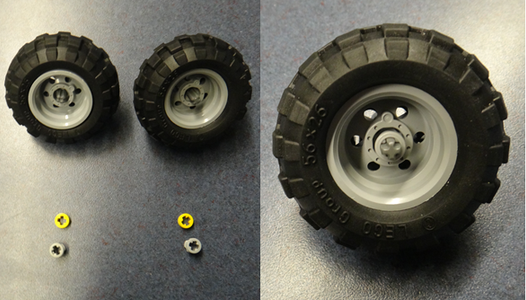

Step 7: Fitting the Axle to the Tire Part 1
        Take the finished products from step 6 and the tires. Insert the finished piece from step 6 into the center cross hole in the tire. The tire should be on the same side as the gear and L-shaped piece. The finished  product should look like the photo above.
Step 8: Fitting the Wheel Axle to the Tire Part 2
Take either the gray hub caps or the yellow hub caps. These are interchangeable. Insert them over the end of the dark gray piece that is sticking out through the cross hole in the tire from step 7. The finished product will look like the right half of the photo.

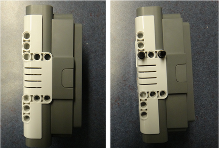

Step 12: Prepping the NXT Brick
Take the NXT brick and four small black couplings. Put the brick on its side like what is shown on the left side of the photo. Take the black couplings and place them in the first and third holes that are in a horizontal line to you as the brick is place like it is in left side of the picture. The finished product should look like the right side of the picture.

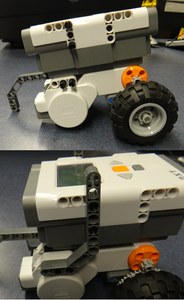

Step 14: Connecting the Brick to the Bot Part 1
Take the NXT Brick, the remaining two arms, and the finished product from step 13. Place the brick on top of the bot. Make sure the black couplings are on the same half of the bot. This set up should look like the top half of the picture. Take one of the arms and connect the shorter side of the arm to the chassis of the bot and the longer side of the arm to the NXT brick. On the shorter side of the arm, the bot couplings should go through the two holes that don’t have a cross hole. On the longer side, the couplings should be placed in the third and fifth hole down from the cross hole at the top. The finished product should look like the bottom half of the photo.

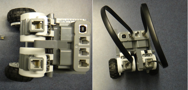

Step 15: Connecting the Brick to the Bot Part 2
In order for the bot to move from a program, it must be connected to the command Brick. Flip the bot on its side so that it sits on it back end with the front end up in the air. This should look like the left side of the photo. Take notice of the ports that are on the side of the Brick. These are where the cables will be connected to the bot. Take one of the cables and place one of the connectors in the port labeled “A”. Connect the other end of the cable into the port on the right side of the front of the bot. Take the other cable. Place one of the connectors into the port labeled “C”. Connect the other end of the cable into the port on the left side of the front of the bot. The finished product will look like the right side of the photo.
